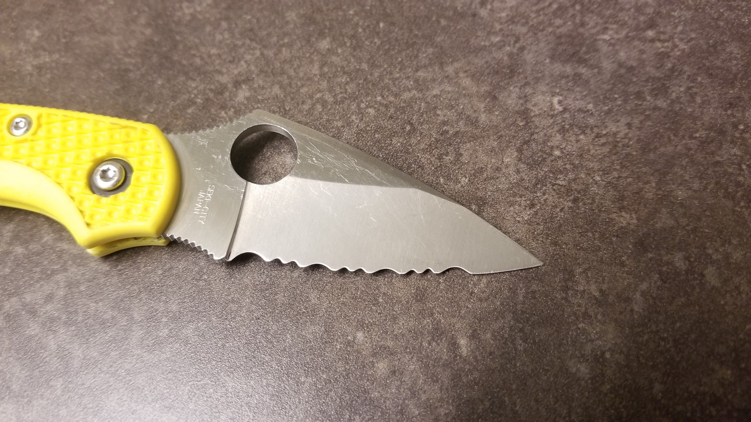

Here's my Pac Salt with the same sharpening as my RJ. It's seen more use so it's not as clean looking but it still slices better than than it did with the factory grind.
@dj. I'd try and keep it as close to 0° as possible. Basically treat it as a chisel grind
-Turbo

Turbo's Rockjumper inspired me to pull out my Tasman Salt and give it some CBN treatment to mellow the serrations.
It's better than it was. We'll see if it's enough to notice a difference in performance. At least it's better than this freebie horror show: :eek:
- Connor

Post by bbturbodad »
The Meat man wrote:
Sun Oct 18, 2020 1:48 pm
Looks great!
-Turbo

Post by The Meat man »
bbturbodad wrote:
Sun Oct 18, 2020 2:27 pm
[Img]https://i.imgur.com/Tpj1wDt.jpg[/img
Looks great!
Thanks! I do wish that there was some way they could grind in the serrations to follow the curve of the blade. You'll notice the last few scallops are set at a pretty extreme angle which makes it even more prone to snagging than it otherwise might have been.
