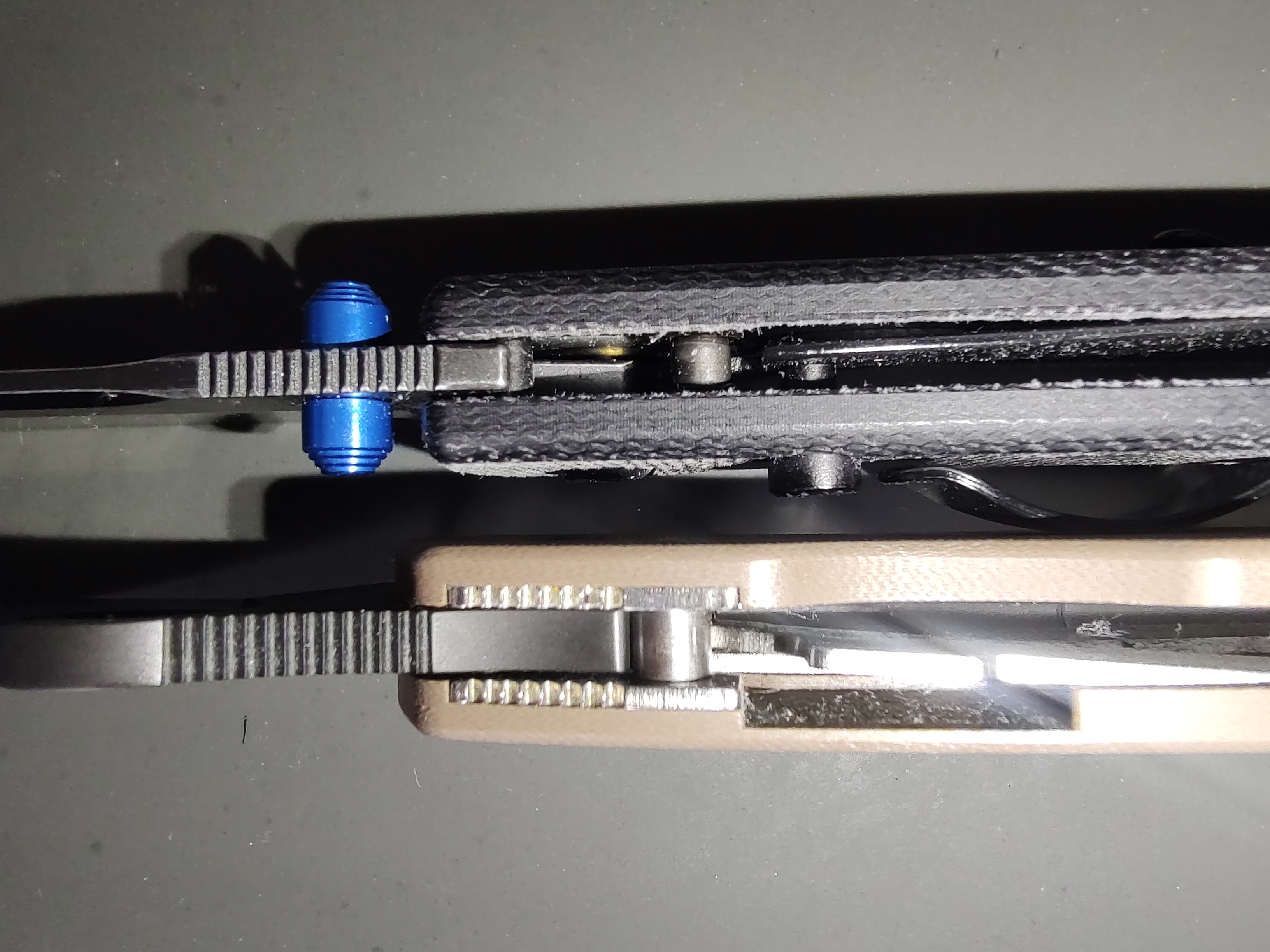

I recently purchased the Vosteed Raccoon with the TLL, as I was interested to compare it to my beloved Spydercos. The model that I bought has a 3.25" bowie style blade mad of 14C28N steel, and black micarta scales with nested steel liners. The TLL is on the right side handle and uses a button on the left side to release it, similar to the Smock. Vosteed offers 3 blade shapes (drop point, cleaver, and bowie) and multiple handle scale options on the Raccoon. They also make the Raccoon with a cross bar lock and a plunge lock. The Racoon is very similar in size to the Para 3. It has a 3.25" blade, and a handle length of 4.25". It opens via thumb studs. And the blade rides on ball bearings. The action is incredibly smooth, and lockup is firm and secure with zero blade play or rock. The Raccoon has a separate stop pin and lock pin, where as the stop pin is also the lock pin on the Para 3. Other than that, the lock hardware appears to be very similar. They both use a detent ball to hold the blade closed. So far, I am impressed with the Raccoon TLL. It feels good in hand, but I do prefer the handle shape and the negative blade angle on the Para 3. And while the action on the Raccoon does feel very good, the action on the Para 3 is better and more "solid". The pb washers give the Spyderco a very distinctive heavy duty feel. The choil on the Raccoon has no guard, unlike the Para 3, and its very easy to cut your finger if you use it to choke up. Its really just a sharpening choil, even though the size and shape of it encourages trying to put your finger there. Thats really a bad design. I also feel like the Raccoon wont hold up as well to abuse as the Para 3. The Raccoon is still very new, so long term reliability is still a big question mark. The Para 3 has a proven track record that will be hard to beat.

I can't really see much there but is that actually a compression lock, or like their acronym says, it's just a liner lock on top? There could be a difference there in the engagement triangle amongst the lock tab and stop pin...

its hard to get a good picture of it, but it is actually a compression lock. Functionally, it identical to Spydercos. There is a tab in the liner that is wedged between the tang and the pin when the blade is openSpeedHoles wrote: ↑Tue Mar 04, 2025 12:52 pmI can't really see much there but is that actually a compression lock, or like their acronym says, it's just a liner lock on top? There could be a difference there in the engagement triangle amongst the lock tab and stop pin...

From your picture it seems that the vosteed is much like the smock where the stop pin is moved away from the locking surface on the blade making it less of a "compression lock" and more of a "three point bend lock", whether that significantly reduces strength? - probably not. But I like the "pure" implementation of the lock as on the PM2 etc.

I picked up a Kizer Mini Grouper several months back to check out their take on the button-actuated Compression Lock & thought it was okay. I did notice that the anvil pin/stop pin on the Kizer was noticeably smaller than the ones in my Spyderco Compression Lock knives.

The previous most popular style of button locks out there use a spring loaded plunger with an angled face that interfaces with an angled face on the tang of the blade. It isn't nearly as robust as a compression lock. On some badly manufactured examples with the plunger button lock, either from bad lock face geometry or maybe too light of a spring, you could easily get the blade to unlock by smacking it on the spine. Sometimes not even that hard of a smack would unlock it.zhyla wrote: ↑Wed Mar 05, 2025 9:22 pmI briefly owned a Vosteed Nightshade (might have been the mini version). Sent it back because they sent the right one. I was really impressed with that knife. The design did it for me for sure. Reminded me a little of the Spyderco Lum Chinese.
I’ll take everyone’s word that this is a compression lock, but this just looks like a button lock to a user. Is it that big a deal?
So the compression button lock that Smock pioneered and other mfg like Vosteed are now using is much safer for the end user. Haven't personally had the unlocking issue on any of the plunger button locks I own, but it's always been a concern and I never trusted them for anything other than light duty. Just looking at the plunger design you can see how it could fail like that. Cool to see Spyderco finally using the compression button lock on other designs like the Sage 6 though.
