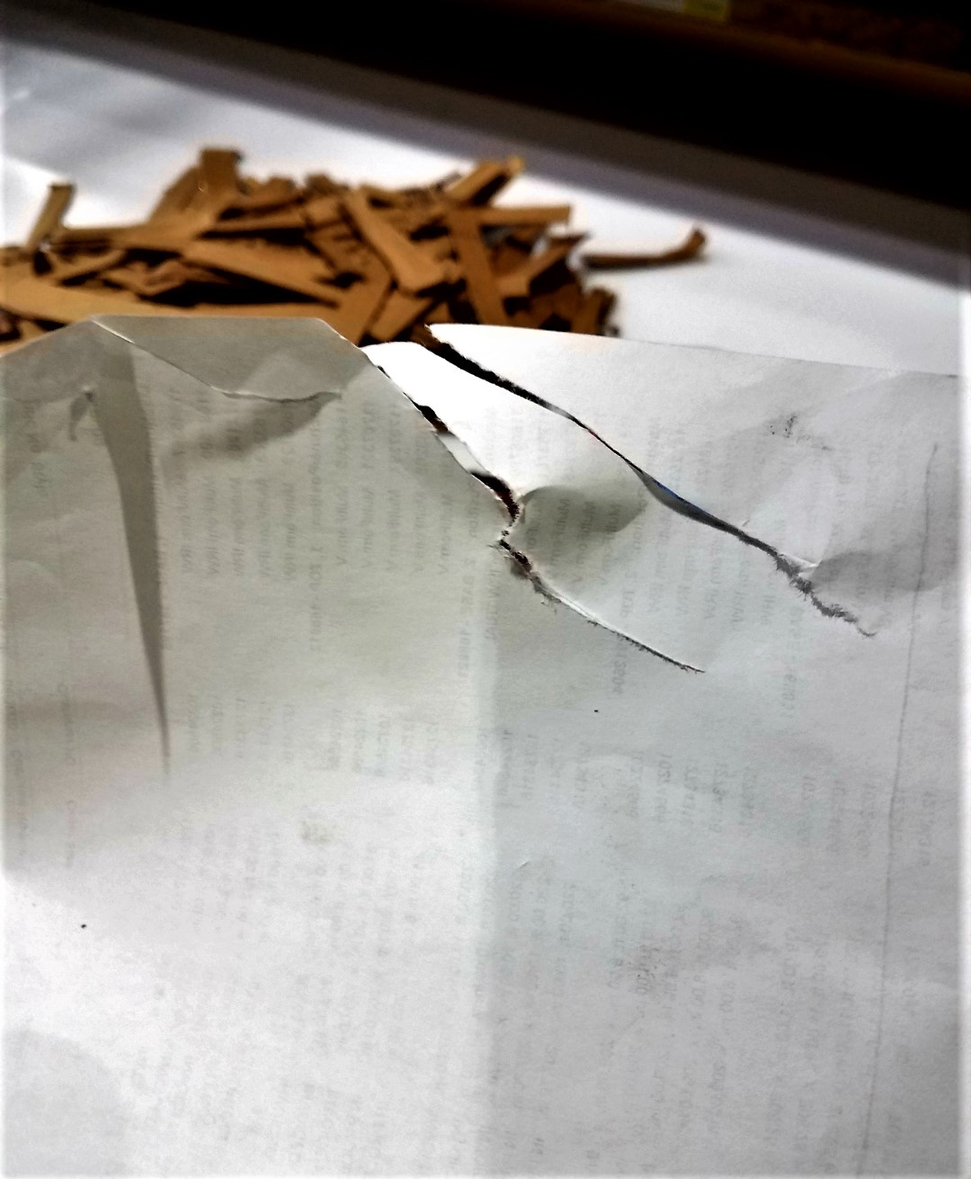

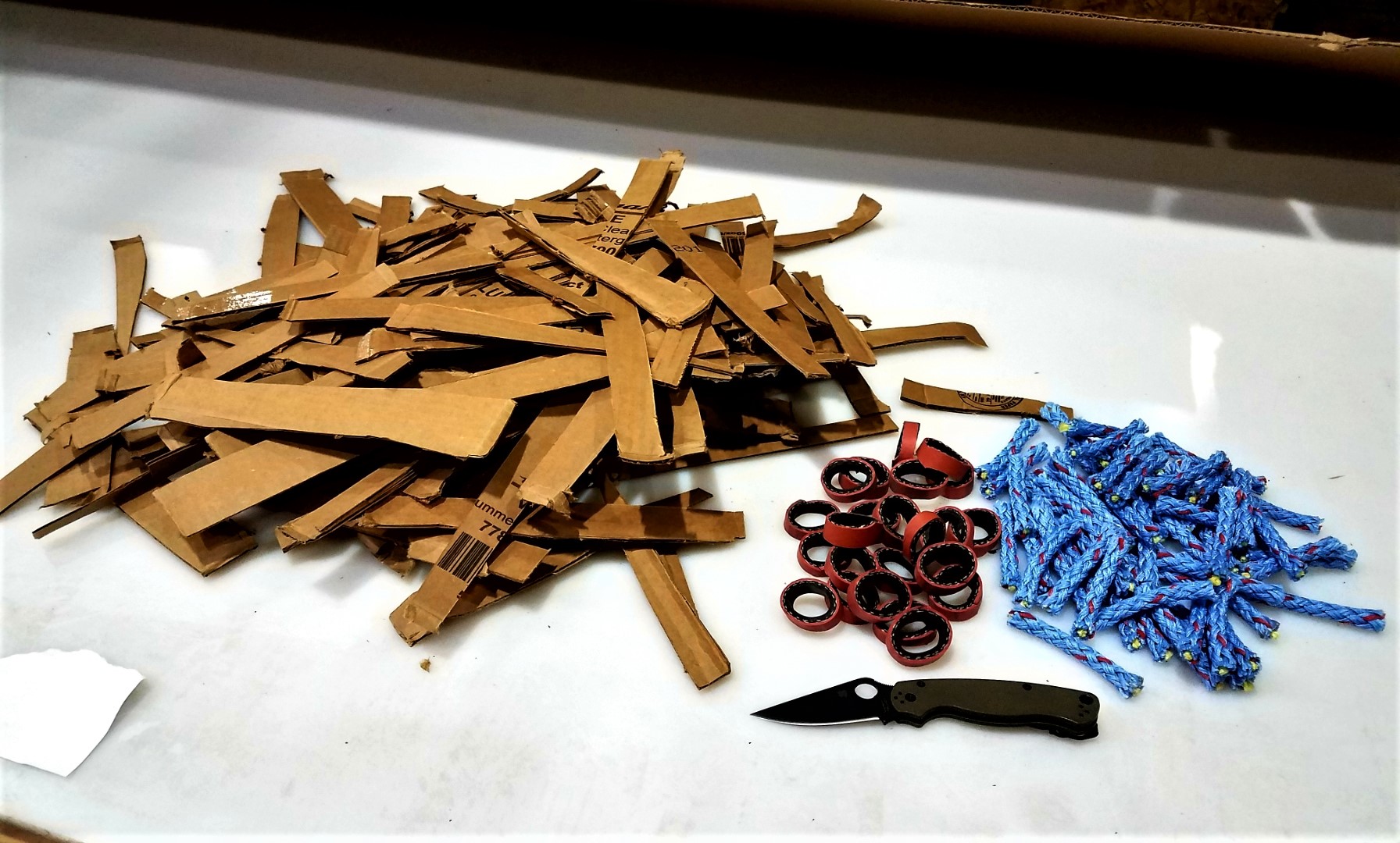

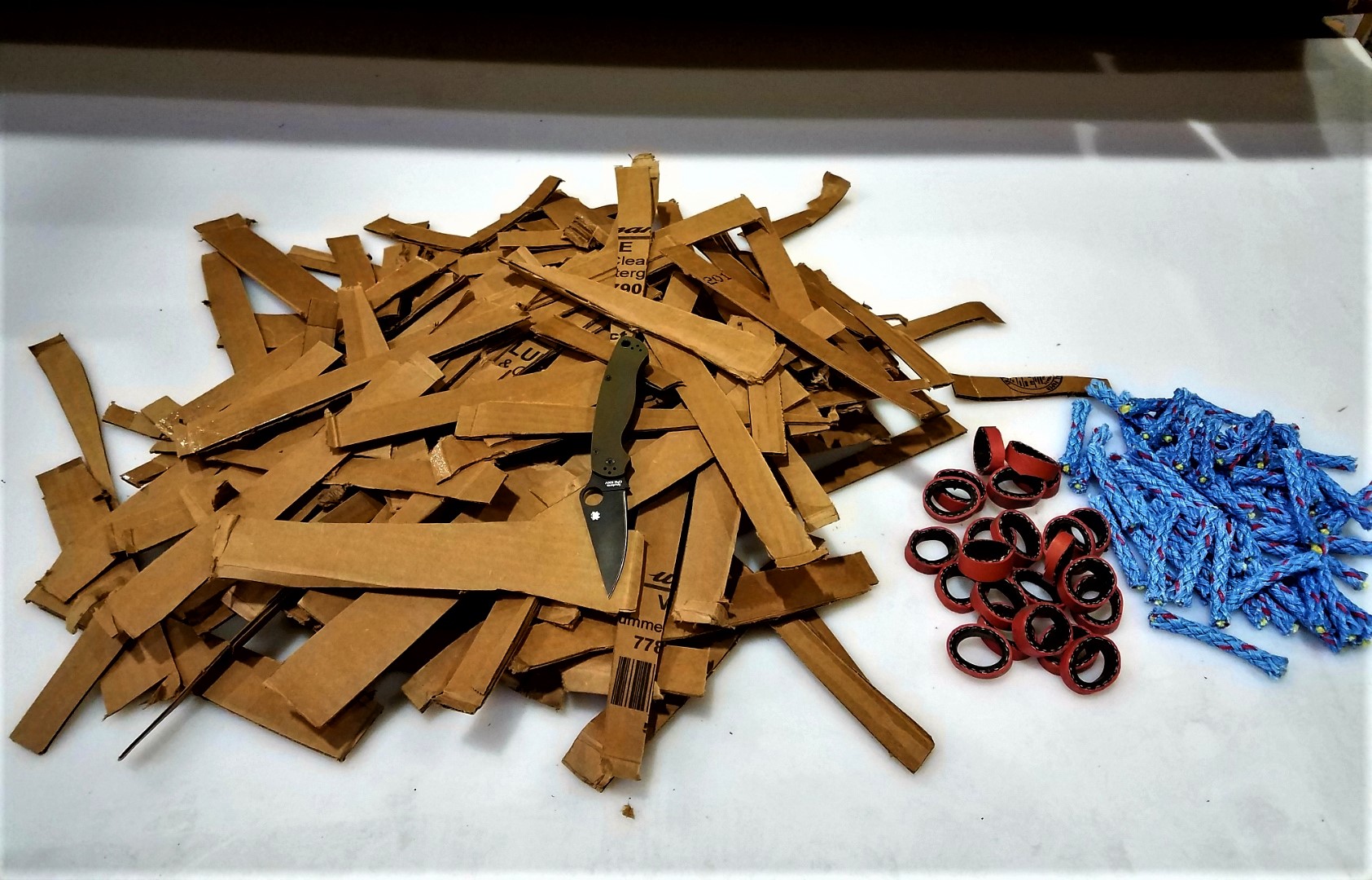

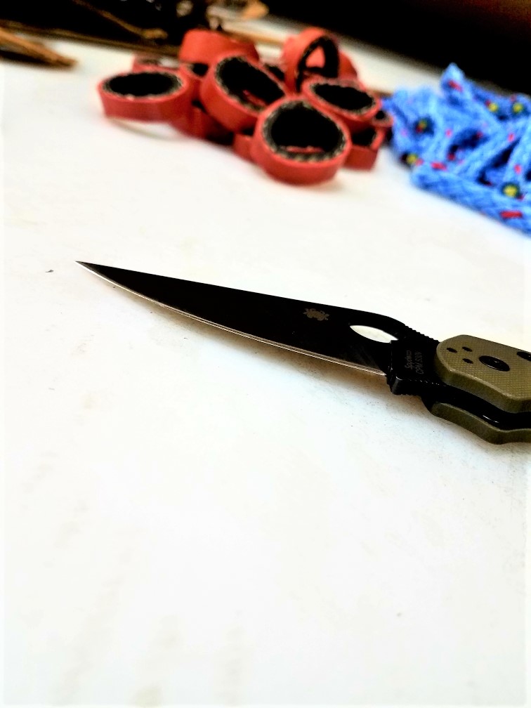

Been a bit since I've done one of these and decided to go with my reprofiled S30V PM2. It's around 14dps, finished on the brown rods and my KnivesPlus strop. No microbevel. I used it quite a bit during the week, more so than some of the others I had posted in here. Because it's been reprofiled, I'm not going to rank it amongst the others because it gives it a bit of an advantage over an edge that's never been sharpened at a grit lower than the brown rods.
That said, going into today the edge had been touched up with 4 passes on each side on the brown rods on Thursday night just to give it a bit more bite going into today because I cut an unusual amount of rope this past week. The knife blazed through the approximate 255ft of cardboard like a hot knife through butter. Same with the rubber hydraulic hose. Cutting 50 slices of rope, the knife never slipped once. I was very impressed with how it performed and then when it came to the paper test...it failed miserably! The edge is pretty reflective at this point and definitely needs a little love later! The way it performed on cutting those 3 materials, I thought it would do well with the paper. Tried it at different angles, but never got a really clean cut. Not sure why, but oh well. Will be an easy touch up later.
This is also the first time I've ever really given a PM2 a good amount of work...and I, well my thumb...really didn't like it. I was wearing cut gloves, but with that high thumb ramp and jimping, as you can see I will certainly have a blister. Just another reason I've come to love the Shaman and Manix as much as I do!
