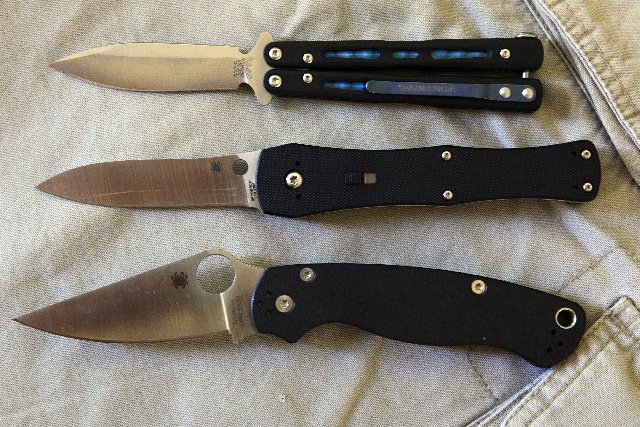

I picked up a Janisong when I was in South Africa last week (thank you to all the gents at Sharp Edge for getting it before I flew out again). I don’t usually do reviews as there are others that are more qualified to do them but I thought that given that this model isn’t available in the US, I’d post a few comments and photos.
Janisong size comparison to PM2 and a Benchmade 32
Handle thickness vs a PM2
First Impressions : Whilst it is probably the size I was expecting, it is fairly chunky and heavy. It is immaculately assembled and looks and feels like a quality piece of cutlery. There are a lot of stainless liner edges and I’ve not felt any burrs or sharp edges. The G10 is almost smooth, possibly the smoothest peel ply I have on a Spyderco – personally, I like that as I prefer the handle shape to provide grip and I don’t want to rely on the handle finish for traction. The jimping is more decorative than functional and once again, I prefer this to aggressive jimping. There is really nice detail design of the lock interface and the stand offs on the liners – I’m impressed by the engineering!

Thanks for the review and pics PS. I was thinking about getting one of these recently but I opted for a 204p Domino instead, if I can save up some more $, I might take a look at the Janisong again, they're not cheap at about $275 but would be nice to have in the collection.

As an aside about the clip, a Benchmade Triage deep carry clip will fit perfectly onto the Janisong, but you'll need different screws - any of the black screws that come with Taiwan spyderco clips will do. It does add to the thickness of the overall package, but much easer to get on and off thicker seams.
I really do wish they had also not skeletonized the bite handle as much(more like with the Blackhawk version). I understand the need for weight reduction overall, but it does decrease the amount of momentum for flipping a fair bit.

Agree with just about everything said above. Only downside IMO "function-wise" is the (already mentioned) slightly too light "inner handle" which ideally should be a little heavier to balance the blade anad give greater momentum. Other than that it's a really nice knife, quite up to Spydercos usual high standard.
