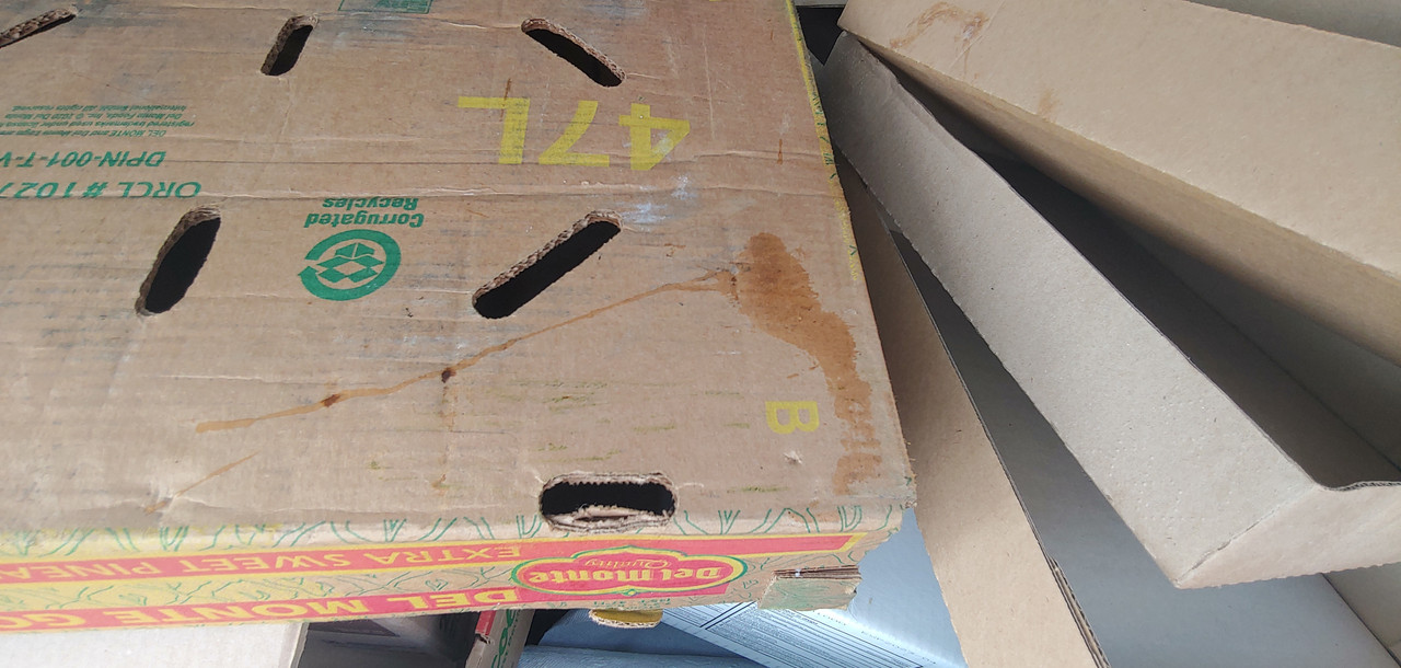

Posts: 16594
Re: I'm going to EDC PE H1 until August
Well the edge still shaves.
I'm getting impatient with how long its taking to dull. Not a problem I expected to have.
Tonight I'm going to slice up a bunch of cardboard, then try cutting some misc materials afterwards and seeing how it does.
When I'm done it'll give me an excuse to sharpen it up again. Probably going with the same sharpening process. 200 grit until the apex is refreshed, refine until it shaves, then stropped on 40 micron. Maybe one stroke per side on the fine rods instead of the strop, I get good results that way too.

My testing with various grits has shown for my uses I can get 3-4x the edge holding by sharpening in the 200-400 grit range instead of using the fine sharpmaker rods.
H1 PE is an amazing steel aside from edge holding. Extremely tough, rust proof and among the easiest steels to sharpen.
By dropping the grit to 200 I've compensated for its weakest area. This has been my first time using PE H1 extensively with such a coarse edge, and so far the results are exceptional.
After carrying the knife for a while I'm kicking myself for overlooking PE H1 as much as I have. It's holding up perfectly well to my EDC uses, and it's a pleasure to sharpen.
I touched it up last night after the cardboard cutting and it only took about 4 passes per side on the 200 grit stone, then stropped once per side. Even at this low grit I'm able to get it catching hairs above the skin.
I'll post a video of some cutting soon.
