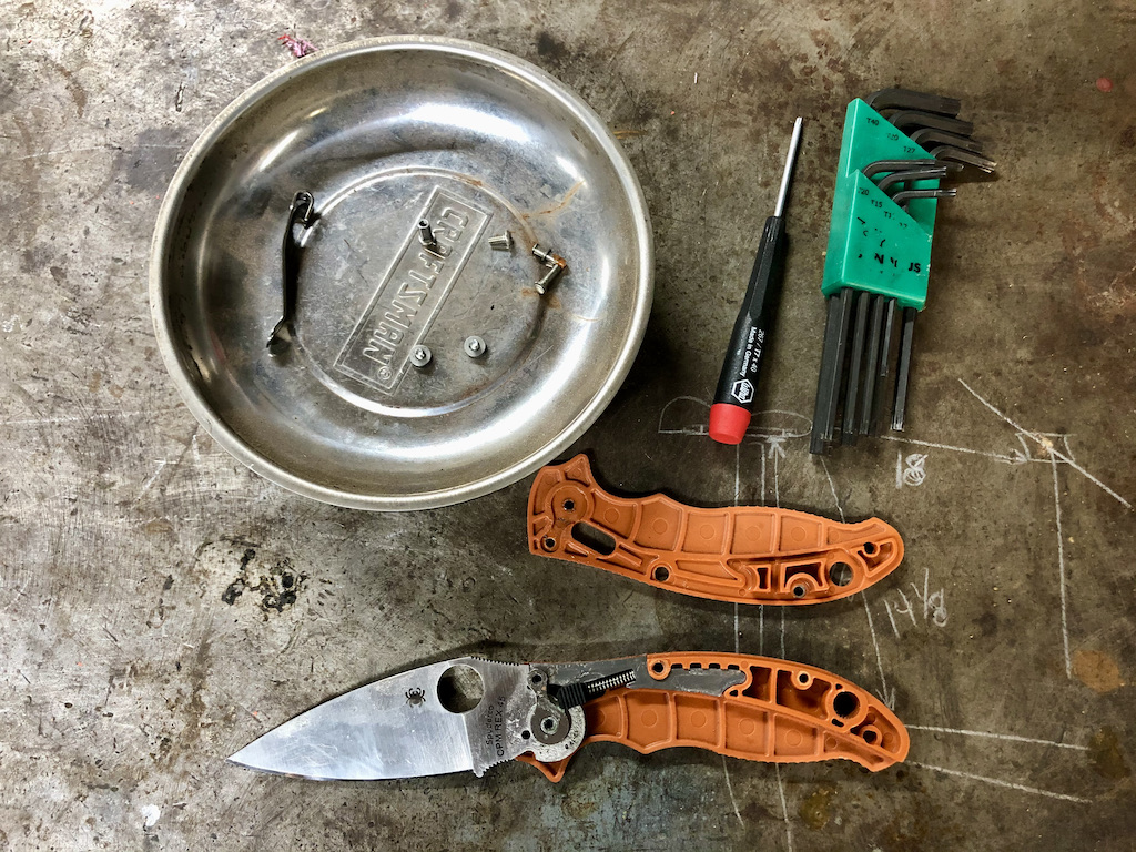

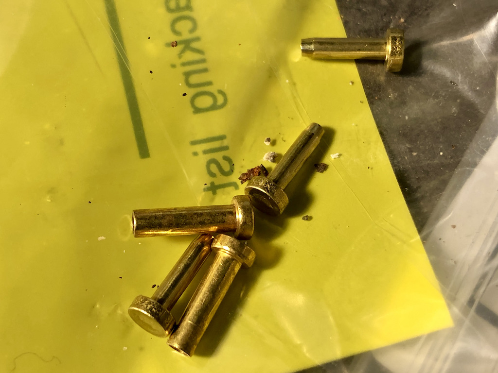

My inspiration was from a couple guys over on that other knife forum. They converted their LW's from rivets to screws. For my own reasons, I didn't like that and chose to stay with rivets. The rivets I sourced were brass, which would have paired well with the burnt orange handle. But my fasteners needed to match a little better, so I plated them in zinc/cadmium, which I had on hand. My rivets are Part Number 96082A100 from McMaster-Carr.

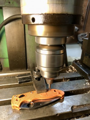

After the plating was started, it was time to blow apart the knife. I was cautious because the rivets appeared to be stainless, and I hate working with stainless. It's hard to start with, and if you're not careful, it will work harden. The internal parts were also a concern, but I'd just have to cross that bridge when I came to it. I used a starter drill that I suspected was bigger than the rivets, with the intention of just going through the head, and then drifting the rivets out the rest of the way.

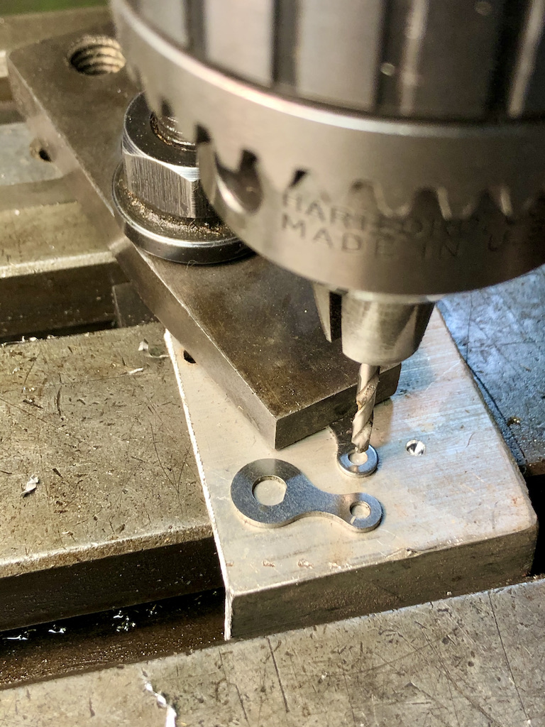

The rivets were not as hard to drill as I thought. But here's a thing about drilling rivets. After you go through the head, the rivet can spin in the hole, creating all sorts of mayhem. In this case, as you can see in the picture below, I allowed a rivet to spin, and it melted away and enlarged one of the holes in the left handle. It wasn't bigger than the new rivet heads, but it was sloppy work on my part. I should have backed up the other side of the rivets and been more careful. I gobbed some epoxy in there, just to fill up space.

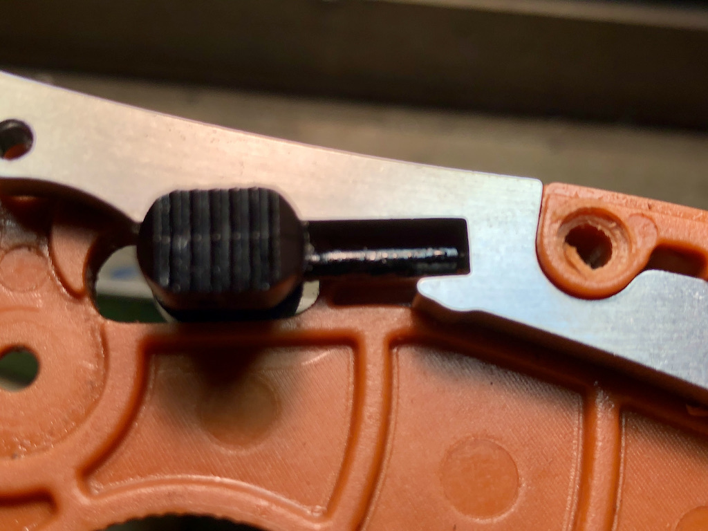

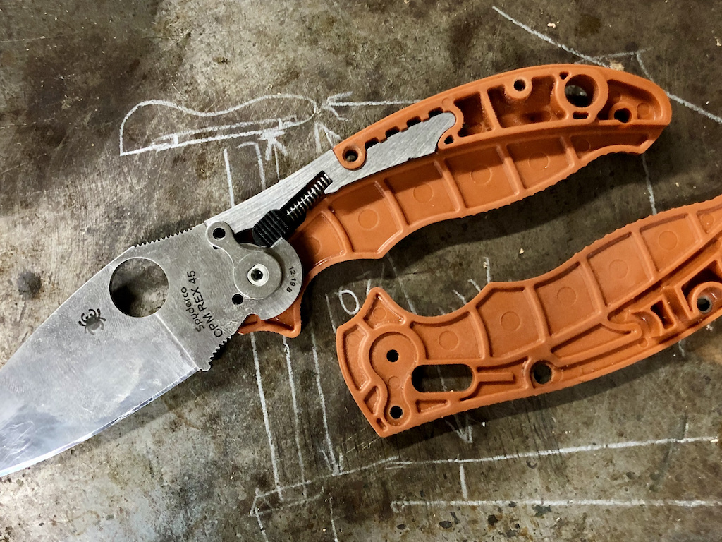

Close examination of the parts revealed why my blade wasn't dropping to my satisfaction. Notice how the spring guide rod is at the limit of it's travel, but the movable button has another 3/32" until it reaches the end of its slot. I ended up grinding off 1/16" of the rod, which would allow the ball to clear the blade by a greater distance.

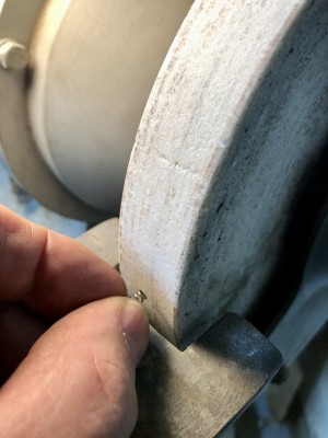

And of course I wanted to shorten the spring a hair. I ground off about 2-3 coils. If you're not careful here, you'll grind off your fingerprints and the FBI won't be able to ID you. The rivets needed to be shortened, as well. The same fingerprint risk exists, in addition to burning your fingertips. Be tough. No crying allowed.
The next step was drilling out the internal parts to match my rivets. The rivets are 0.112", so I drilled all the holes to 0.116". The stainless wasn't difficult to drill, but you need to remain aware of work hardening. Cutting oil was used, the drill was sharp, and I didn't dilly-dally.

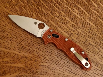

Here's the knife ready to go back together. The holes for the rivet heads were not all exactly the same depth after I drilled out the rivets, and my new rivets sat too high. I held up the handles by hand to a spinning end mill, and carefully deepened the holes. I left the rivet heads just a hair high, so it would make it easier to back them up and hammer them down.
Here's the finished knife. I think the new rivets look pretty good. The ball cage moves back further now, allowing freer action of the blade. The shortened spring doesn't make a substantial difference in actuating the lock, but the blade seems to flick open much more freely now. Did I NEED to spend three hours on a knife that was pretty good from the factory? Probably not. But I thought I could make it just a hair better, and I did. So for me, the exercise was a success.

A lot of thoughts went through my head, probably none more valid than any other. I've seen two sets of pics from other guys who took apart LW's. The first one, I didn't like the look of the screws. The second one was a little better, but didn't excite me. The screws were 2-64, and at the time, I thought too small. I tossed around the idea of making inserts, then using flat head screws. That would look cool, but in the end, I decided it was too much work.
Since rivets were cheap, I bought a couple bags, thinking they were nickel plated. But they showed up and they were brass. I sat on it for a while, almost deciding to just use the knife as-is. Then I decided that screws were the simplest solution, but I already had rivets. It's highly unlikely I'll ever disassemble the knife again, but if I do, I know how to do it quickly, and I have a lifetime supply of rivets.
Since you already have the tools, you can probably knock it out without much time or effort. I still think that flat head screws would be the most functional and look the best. Good luck with yours.

How would you stop the rivets from spinning when being drilled?
Re: Manix 2 LW: Doing It My Way (no screw conversion)
That's an excellent question that's been asked by frustrated rivet drillers since the very first time a the end of a pin was peened by the illustrious Walter J. Rivet.ChrisinHove wrote: ↑Sun Nov 15, 2020 4:09 am

This project turned out great and glad you documented the process. Many chuckles were had at the grinding part. Is there a functional difference between grinding vs cutting the spring?RustyIron wrote: ↑Sat Nov 14, 2020 12:29 pmAnd of course I wanted to shorten the spring a hair. I ground off about 2-3 coils. If you're not careful here, you'll grind off your fingerprints and the FBI won't be able to ID you. The rivets needed to be shortened, as well. The same fingerprint risk exists, in addition to burning your fingertips. Be tough. No crying allowed.

In this situation, it doesn't much matter. Some springs will nick your cutters, and sometimes you can inadvertently bend a spring by trying to get between the coils. In this case, it wasn't a big deal and I just instinctively stepped over to the grinder. And I think that's the whole point of a post like this: there's a bazillion different ways to accomplish a task. You look at the job, look at the tools and materials available, then go from there.
