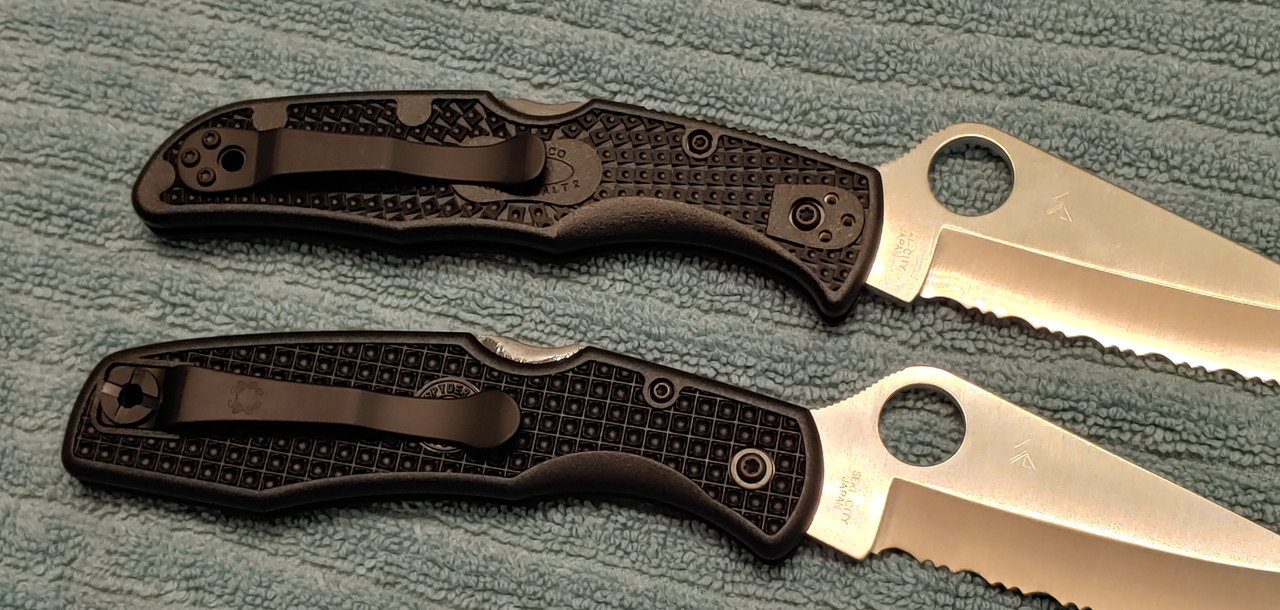

Throughout its ~13 year run, the Pacific Salt went through many revisions. The clip was more squared off and jimping was coarser on early versions:

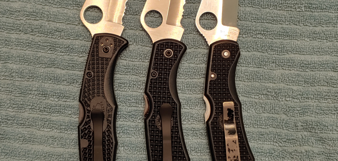

From left to right, a gen 2, late run gen 1, and early run gen 1.
Interestingly the Pacific Salt 1 adopted some of the characteristics of gen 2 before it ceased production. Made December 2019, this one sports blacked out hardware and Sal's logo:

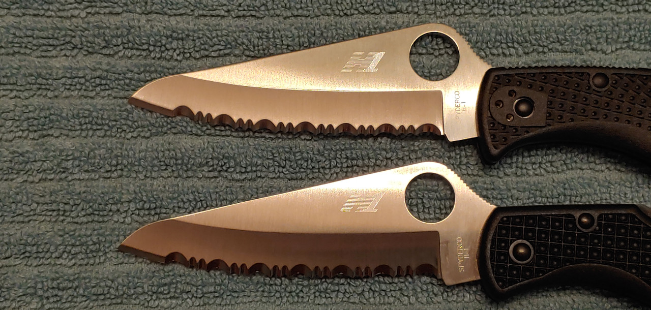

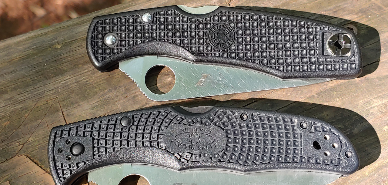

Blade
The blades are essentially identical. Very little has changed between the two generations. Here is an image comparing a brand new Pacific Salt 1 vs 2, both serrated:
The Pacific Salt 2 (top) seems to have a slightly smaller kick.

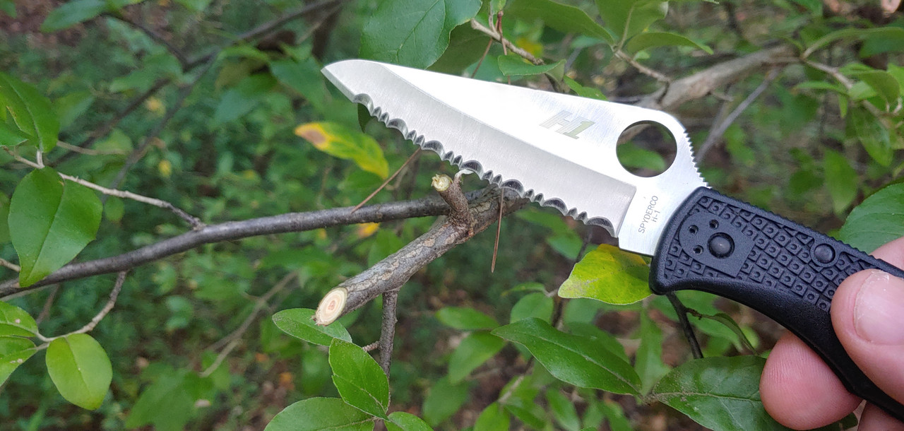

I've been maintaining the knife with a fine sharpmaker rod, and sometimes I'll follow up with Venev 7 micron diamond paste on a custom strop.
Here's a video showing my typical touch-up process: https://streamable.com/7lpkll
The edge has held up well, just like my experience with the first gen.
I'll sometimes use it to cut through small branches like this on running trails. No rolling at the edge.

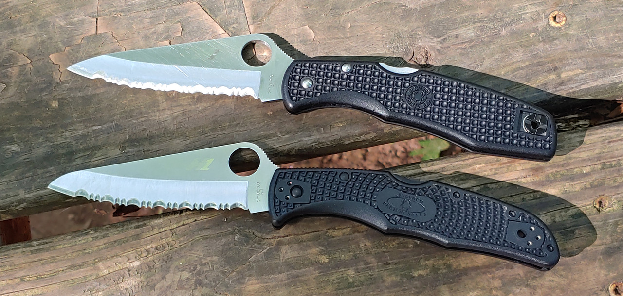

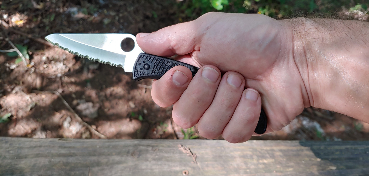

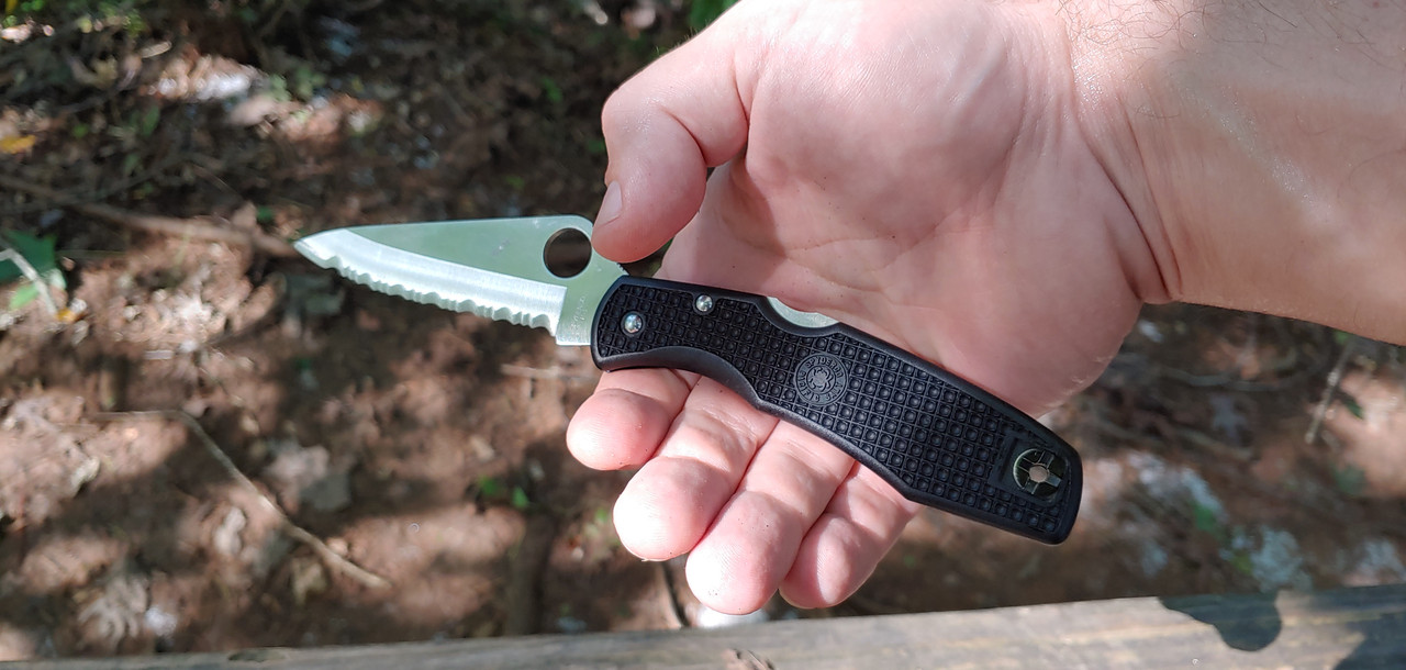

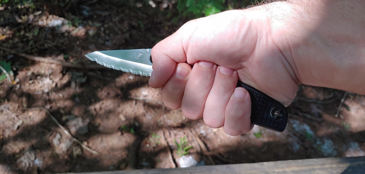

The ergonomic differences are what intrigued me the most.
I had previous experience with the Endura 4, and didn't remember the handle working very well for me. When Spyderco stopped making Pacific Salt 1's I stocked up, thinking the 2 wouldn't work for me.
Thankfully I was willing to give the handle design another shot, and I'm glad I did. I've come to appreciate the versatility of the design. It's ergonomic in a wide variety of grips with its neutral shape and subtle finger grooves.
Here's a video where I discuss the ergonomics and overall differences between the two generations: https://streamable.com/dpy4uh
The texturing is much better on the second generation. Carrying the Police LW I knew I'd like it better than the volcano style texturing.

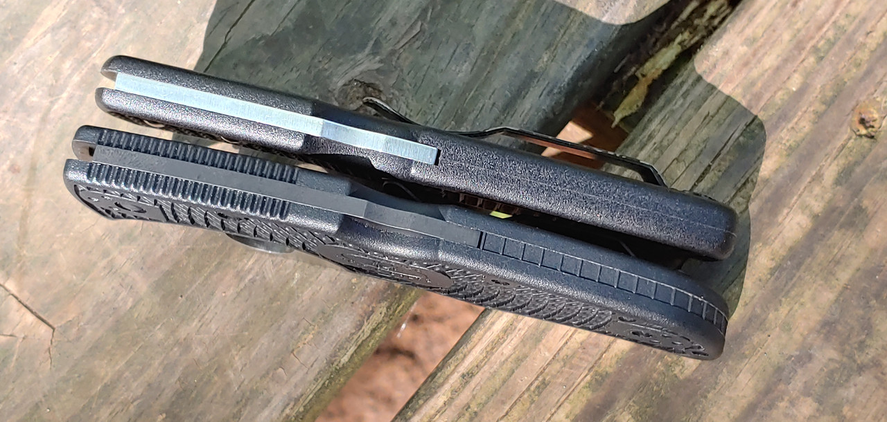

The jimping on the spine is a welcome addition as well.
The subtle changes to the finger grooves gives the handle more versatility. By making the guard more abrupt and widening the first finger groove, I get a comfortable grip choked up or gripped further back. This grip doesn't work for me on the Pacific 1.

The clip has gone through a few changes. Instead of the Endura 3 tip up only clip held by a single large screw, we have an Endura 4 style four way clip mounted with three small torx screws. The handle has metal inserts embedded for the screws to grab on to.
The clip is also a good deal smaller. This plays a role in improving ergonomics. I feel it less while using the knife. I still find it carries just as well.
