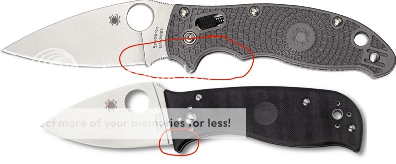

1. Sharpening choils. This was one that I even intentionally added to a couple of my knives to experiment with, only to realize that they ultimately result in a snag point at the heel of the blade and are absolutely a no go for me. These could be remedied by making the choil a single large serration so that it doubles as a sharpening choil but also has an edge to it, but I guess we haven't evolved to that point just yet.
Examples:
Spyderco used to add small notches to a lot of knives, and those are less problematic because they're smaller, but they still snag on some materials and I'd rather they just weren't there at all. The Centofante 3 has one of these smaller notches:
There seems to be a trend lately of adding much larger choils to blades, I guess as a sort of finger choil more so than a sharpening choil, and for me these only exaggerate the issue. The Amalgam isn't too terrible, I imagine that choil is shallow enough that material would slide out of it and onto the edge, but the Smock is an absolute head scratcher for me, that choil is practically designed to hook and snag things.
