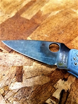

Thanks for the suggestions guys. Impatient me really wanted a patina so I went ahead and gave it one when I got home from work late last night. I used white vinegar on the laminate line of Vtoku2 before and I liked the look, so last night I whipped up an odd mix to see what happened...I cut a lemon into 4 thick slices and put it in a glass, added a bit of pickle juice and a couple teaspoons of white vinegar and stabbed the knife into the lemon slices. I then took a shower and had a snack. Around 35 minutes later, this is what I got...
I'm stuck in the warehouse all day, so I couldn't take the pics in natural light. I guess it's not too bad, I hoped for more imbalances on the show side. I like the way the clip side turned out though. A bit more blue would have been nice, but it is what it is now! I don't really care much for the model itself. It's a bit underwhelming. I thought it would be comparable to the Chaparral...that it is not! No jimping on the index choil and ramp is a bit of a bummer. Regardless, it's going to be a keeper and user that I'll experiment with. I cut a lot of abrasives at work, so I'm wondering if the patina will wear away a bit and form a newer one as I continue to use it? That's happened a few times with my Vtoku2 Dragonfly.

It likely would have taken years for me to naturally develop a patina. I have a very hard time carrying the same knife a few times a week, I'm constantly rotating. I also lack patience when I have an idea in mind haha.
