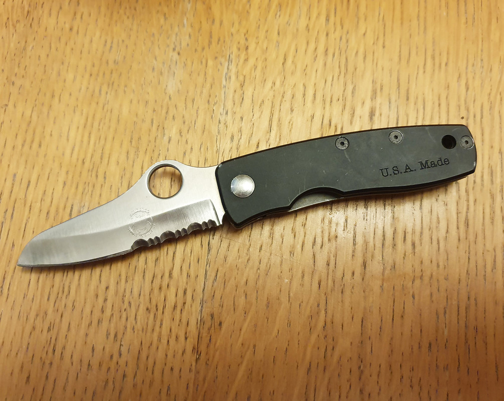

As the header says - is it possible to re-attach, for lack of better word the coating on a Almite handled knife?
Got a C19 as a gift yesterday that i'd love to bring back to as-new condition. It's not bad really, a couple of nicks and chips, but i have never heard or read if it is possible, should i want to.

Don't think that's Almite, Larry. Mainly because the 1993 catalog describes the Terzuola's as having "anodized aluminum" handles, but also because Almite is normally shiny while every Terzuola I've ever seen was dull looking and felt almost chalky. Not sure if you can partially refinish an anodized piece, but I guess the entire handle could probably be taken down to bare aluminum and re-andozied.

Almite is an interesting and elusive beast; so far as I can tell it isn't a specific process, but rather a fancy name for anodizing.
"Alumilite" is a specific, trademarked anodizing process developed by Alcoa, but that's not what you usually see listed. In the rest of the world, "Alumite" seems to have become a popular way to describe anodization in various forms, and Almite seems to be yet another permutation of the term.
Reference: https://www.finishing.com/63/19.shtml
That's not to say you can just strip the coating off and anodize/dye/seal the scales any old way to get the same effect. There's some specific process that Spyderco/the shops in Japan used.
FWIW, my Cricket has a rich, dark matt grey, while my Civilian has a lighter, slightly more reflective grey. Not all Spyderco Almite is the same, just as not all carbon fiber is the same. The process is surely repeatable by someone who knows the tricks used, but when coatings like Cerakote are widely available I think that's probably the way I'd go.
