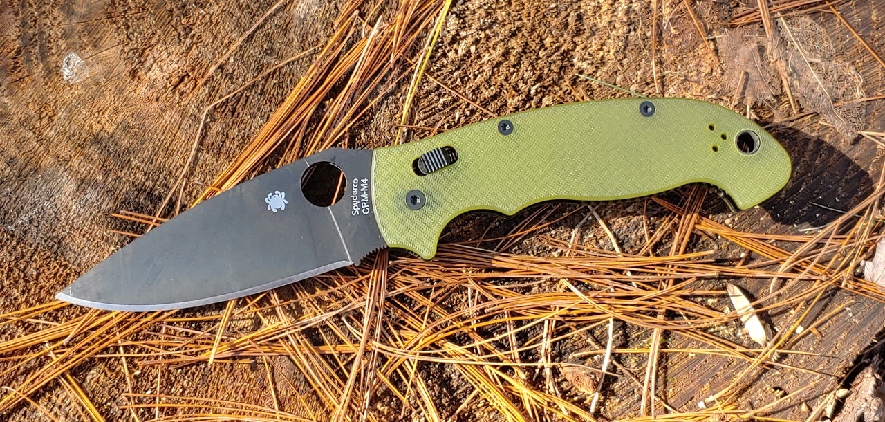

Last touch-up before I reprofile. LC200N Pacific Salt 2 @ 20°
https://i.postimg.cc/fywBnT1Z/20201113-023435-HDR.jpg
