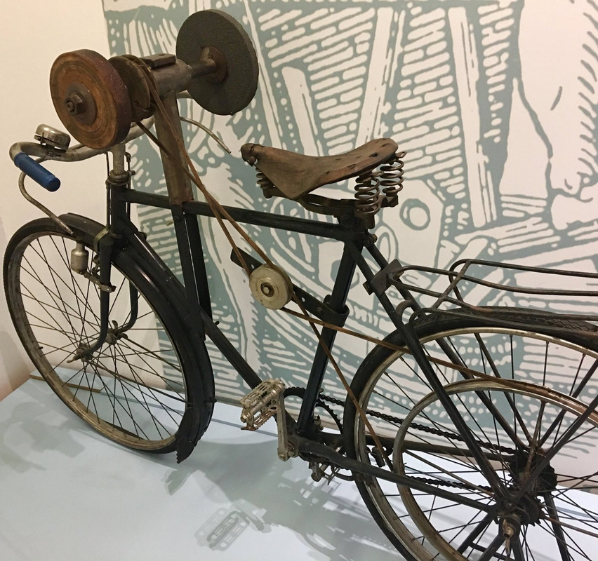

Re: Community Sharpening Journal
Posted: Thu Oct 01, 2020 8:20 pm
by Bloke
Thu Oct 01, 2020 1:11 pm
Powered sharpening is so fast and easy.

Bloke, that picture is perfect! :D
