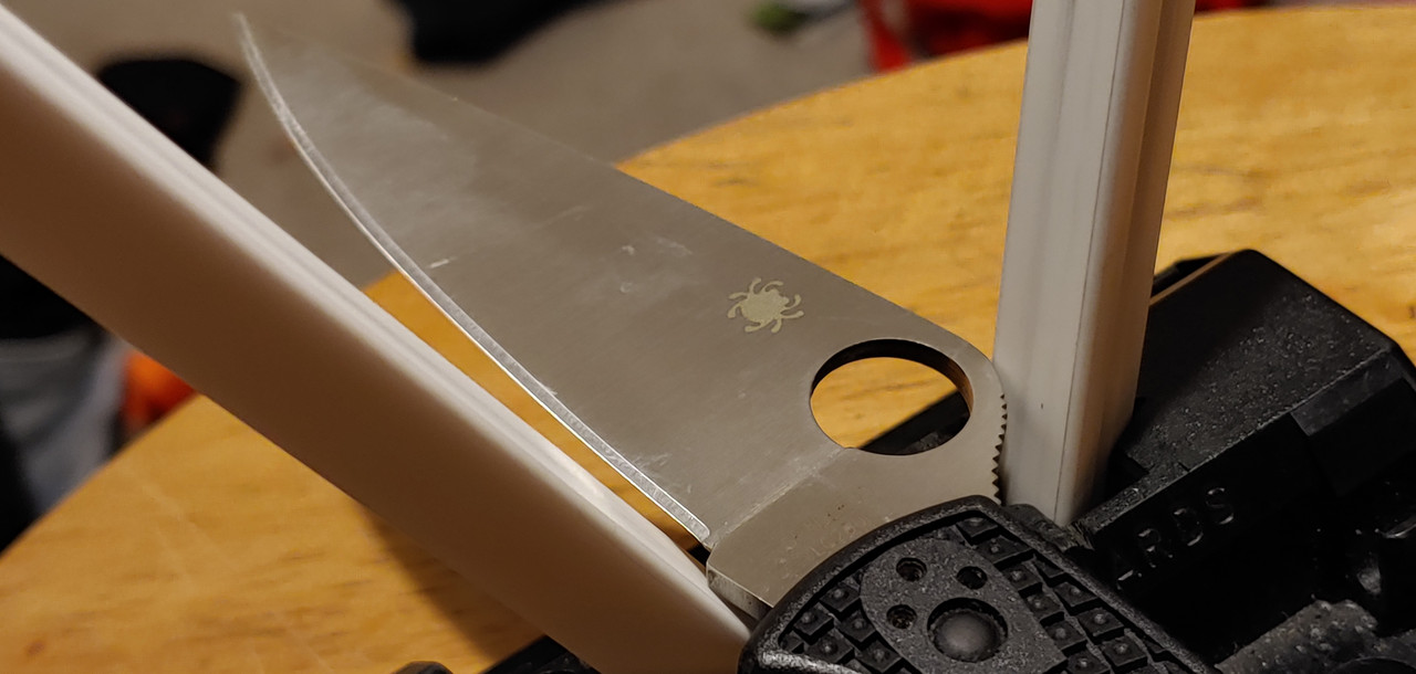

Postby vivi » Fri Nov 13, 2020 1:37 am
Last touch-up before I reprofile. LC200N Pacific Salt 2 @ 20°
