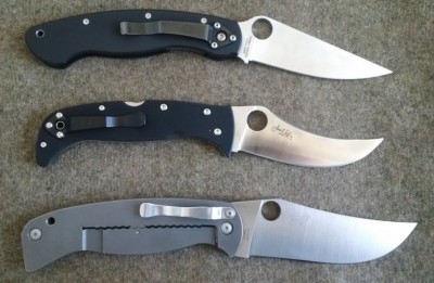

Should the blade of my new knife ever be able to make contact with the back spacer on a back lock?

Chinook 4. Seems the blade is making contact. The blade can be pushed down into the handle(doesn't take a lot of force)

For reference while holding both knives closed in my hand...... My manix 2 back lock blade can not be moved when in the closed position, but the Chinook lock flexes and allows the blade to move towards he back spacer and seemingly contacting the back spacer.... two very distinct shiny spots about an 1/4" long each on separate areas that make me believe the blade is contacting metal

Well, hmm. I just checked my new-today Chinook 4.
With just a gentle thumb -and-index-finger pinch (less force than for popping a bubble wrap pocket) I felt the blade "bottom out."
I then checked with a 7x loupe and a light while repeating the pinch, and could see contact. Opening the blade, two small flats were plainly visible. This was the first two and only two times I opened and closed the knife (of course closed a third after pix).
Here is a quick pic which shows one shiny flat, though not very well.
While I usually only use power grasp on a closed Spyderco folder with the Jot Singh and Assist models, for some of their intended purposes, I think that normal EDC handling and activities with the Chinook 4 might also produce this effect unintentionally, without any power grasp per se. hmm

Glad I'm not the only one. I REALLY like this knife, but this is very concerning

I spoke to someone in warranty just a moment ago. He said he was going to inquire about the lock itself and get back to me. He further explained that back locks... like username on the manix 2 BL, actually stop on themselves when closed which is why they don't move in he handle. He let me know it's the first time he has had to field this question. They have my information and will be contacting me

Since the Power Lock is quite different internally from the traditional back lock I have to wonder if the movement the OP is experiencing is normal. Looking at the pictures of the Power Lock in the current issue of Byte it sure looks like it could be.

The issue I'm having as well as another user here is that it actually contacts and rolls the edge on the backspacer. If it had movement but didn't touch.... that would totally be a different story. I can't imagine they would design the knife to purposely be able to contact he back spacer and potentially dull the edge. It does not take a lot of force to move the blade at all.... when light pressure is applied to the back when closed you see the power lock flex. It's supposed to operate similar to a back lock, but being this is only the 2nd knife released with this lock it's tough to gauge.

update : Warranty called back. They pulled a Chinook 4 and also noticed the lock movement, and will be discussing it at a meeting later this week. I should hopefully know more by Friday.

From my knifemaking experience;
You want the blade tang to contact the lockbar pivot area when closed, like the delica and endura do. If it contacts forward of the lockbar pivot, the blade can be squeezed into the handle.

yup, I checked both my endura and manix 2 back lock and both are rock solid when closed.
