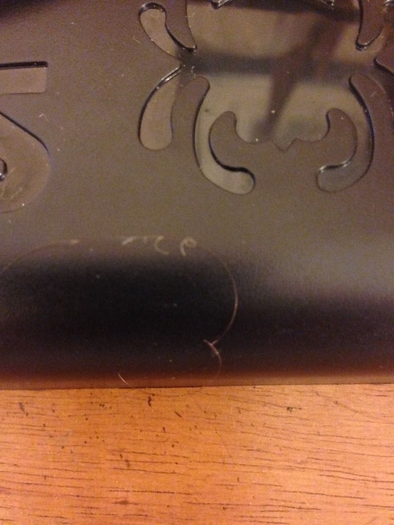

I commonly use coarse particulate abrasive stropping to create convex microbevels on my knives and to touch up that convex microbevel between full sharpenings.
Crossposting an explanation of the complex non-linear relationship between stropping compound abrasive particle size and effective grit:
Basically, when you apply particulate abrasive stropping compounds to a compressible surface (e.g. leather, balsa wood) the size of the abrasive particles will not correspond to how coarse or fine a finish they will leave on a knife apex. This is because the abrasive particles get pressed into the compressible surface of the strop, meaning they cannot cut to their maximum scratch depth, and, because the surface is compressible it also cannot press into the knife edge with the same amount of force (and therefore pressure) a solid abrasive would, thereby additionally reducing the scratch depth. This effect becomes more and more severe as the size of the particulate abrasive particle increases up until the abrasive particles get so large that they stop sinking so far into the strop surface (which begins to occur above 30 microns).
In practical terms, this that a 16 micron CBN emulsion on balsa wood will still produce an apex finish with extremely high push-cutting sharpness (high enough to very easily do crossgrain pushcuts on newsprint), while still having enough slicing aggression to cleanly slice through folded over paper towel without slipping.
That 16 micron CBN on balsa will also cut fast enough to create and touch-up (back to ~100% of initial sharpness) a convex microbevel for some time between full sharpenings on a light use EDC knife, and because the 16 micron CBN on balsa leaves some slicing aggression, there is no danger of "over stropping" the apex.
For example, my Spyderco Spydiechef has a ~10 degree per side edge bevel that was shaped to 1000 grit and then a 16 micron CBN on balsa convex microbevel was applied. You can see below that the 16 micron CBN on balsa finish produces a semi-mirrored edge bevel, despite how "coarse" 16 micron CBN emulsion is (in theory) as this convex microbevel has been touched up repeatedly over the last week or so:
Here is another image taken of a different knife stropped on 1 micron CBN on balsa on the left, and a knife with a DMT EEF freehand microbevel on the right. Each half of the image shows a ~1.1mm length of edge:
You can clearly see the similarities between the v-shaped microbevel and the strop induced convex microbevel. This is also why you should never do both on the same apex.

The Spyderco solid sintered ceramic stones not only have an effective grit way different from their stated ratings, but it also changes depending on how much they have been used. My Spyderco M benchstones produces a finish similar to a DMT EEF (i.e. ~4000 grit) at this point.mb1 wrote:Yeah, as I poked around I could see there's a lot of subjectivity here. Good to hear your experience.
