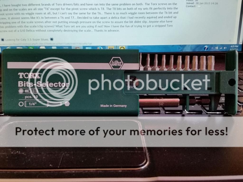

Ok, I have bought two different brands of Torx drivers/bits and have ran into the same problem on both. The Torx screws on the clip and on the scales are all size "T6" except for the pivot screw which is T8. The T8 bits on both of my sets fit perfectly into the pivot screw with no wiggle room at all, but I can't say the same for the T6.. There is so much wiggle room between the T6 bit and screw, it almost seems like it's in between a T6 and T7.. Decided to take apart a delica that I had recently aquired and ended up stripping one of the scale screws after not putting enough pressure on the screw to assure the bit didnt slip. Anyone else have this problem with the scale/clip screws? What Torx set are you using if not? Now I have the fun of trying to get a stripped Torx screw out of a G10 Delica without completely destroying the scale.. Thanks in advance.

This is the set I use Lux, its made by Wiha

farnorthdan wrote:This is the set I use Lux, its made by Wiha
I'm also using Wiha..
Do your T6 bits fit snug?? I can put the T6 bit in all of the handle screws in every one of my Delicas and wiggle the driver back and forth. I have about 8 different delicas and it happens on all of them. I have a Kobalt set also that I got from Lowes, same problem. The T8 fits great in the pivot screw.. But lots of play in the T6 handle screws. :confused:
