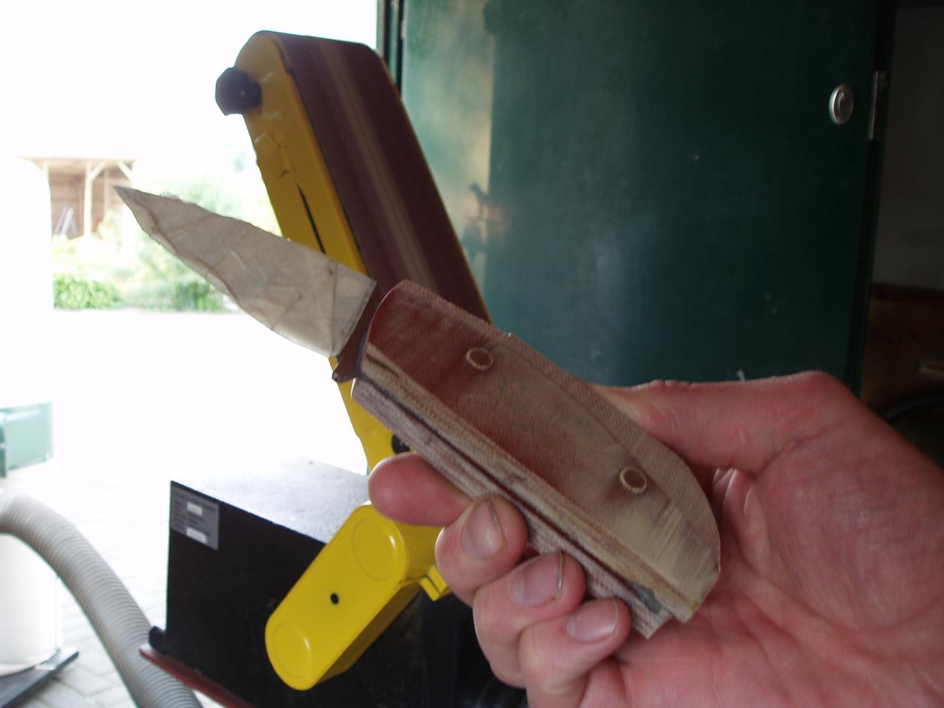

Here we are; we have a blade with two (very) rough chunks of micarta attached to it. It is time to shape it. Before I show you how, let me tell you a little about the tools I use. The main apparatus is my belt grinder for the large removal of the micarta and shaping the handle roughly. Next I use round files to remove material from the deeper areas that I can not reach with the grinder. Finally I use a dremel tool and plain old, handheld, sandpaper and water.
The very first thing I do is grind the corbies even with micarta. I use a coarse belt on the grinder. In this case that is fine, since there is lots of micarta to be removed. However watch your step with a coarse belt. It eats a hole through tang and handle before you can say the word 'mule-pro-ject'
militaries 218.jpg (85.47 KiB) Viewed 3051 times

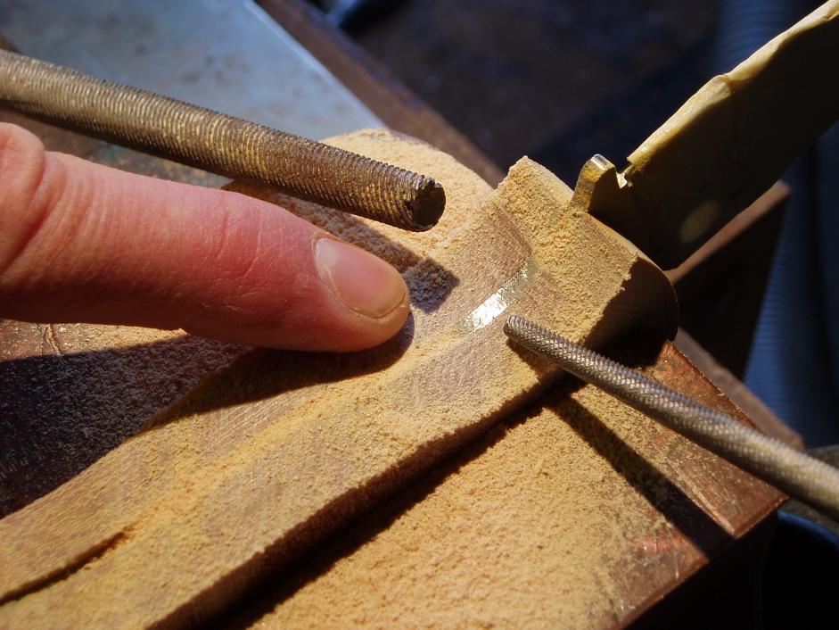

Next step is to expose the tang removing all the excess micarta.
I use the grinder on the rounded area. Becareful that the grinder does not pull the blade out of your hand destroying the guard or the blade a the top.
For the hollow parts and these (mentioned) 'risk-areas' I clamp the knife in a vise and use the files to remove stuff.
Despite the fact that the blade might be protected with tape I use copper (softer metal) holders to prevent denting and scratching. That shown oldschool-vise is bad clamping news, even on Rc 65 :D
militaries 219.jpg (95.34 KiB) Viewed 3033 times
Tom

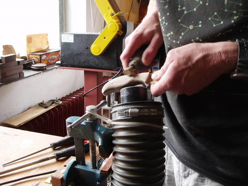

Here I clamped the blade in a vertical vise. After the grinder I use both files and the Dremel-tool to remove stock. Note that dust extractor is still there, Safety first! I start with the dents in the handle, the frontchoil where you can choke the blade with indexfinger and thumb. Similar dents are made at the back.
militaries 228.jpg (93.42 KiB) Viewed 3066 times
Tom

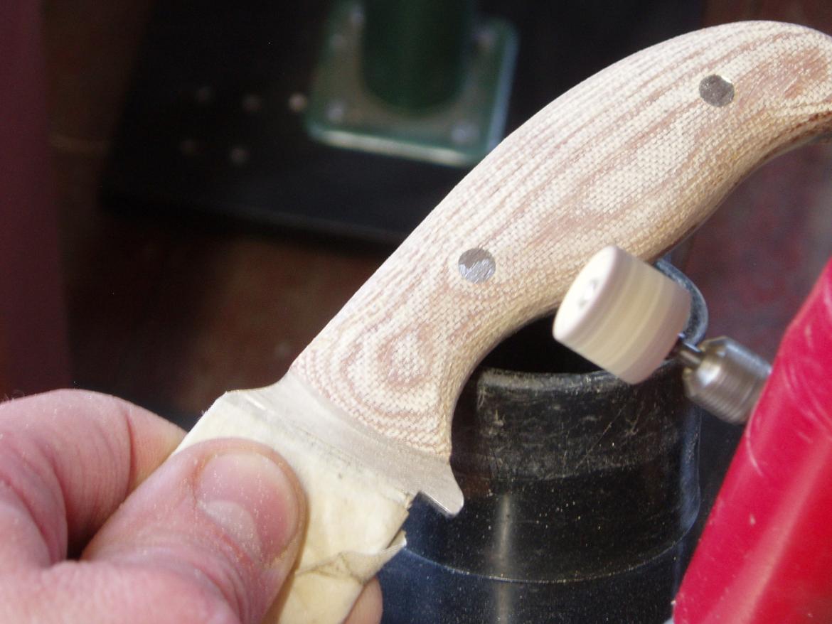

Using the Dremel tool above the dust extractor. Same story on the Dremel-tool; start using a coarse grinder at start (and continue with finer). I again will repeat my caution; too coarse and too fast WILL EAT AND DESTROY YOUR KNIFE! Be careful. Another important warning is not to hold the grindingmachine too long on one spot. There is always a chance that the heat-buildup alters the temper of the steel. Besides that a dull belt can start burning on the micarta, blackening it. Those are things we do not want.
Since the chosen material is built up out of different colored layers, you can play with the pattern. The layers guide you while grinding, sanding and filing.
militaries 232.jpg (94.19 KiB) Viewed 3020 times
Tom

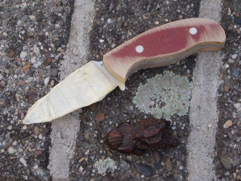

Developing the shape further and further. Check the 'eyes' that come out of the material. A big one between the corbies and two small at the front and the end of the handle.
militaries 244.jpg (92.28 KiB) Viewed 3027 times
Tom

When the shaping is good I finish the exposed tang sandwiched in the micarta. I use a 'dull' finer grinder on the dremel tool. This to finish the steel as smooth as possible and avoid removing too much material at once. Check if the steel and micarta is flat on the tang and correct this with dremel. Protect your eyes for the sparks
militaries 246.jpg (98.71 KiB) Viewed 3026 times
Tom

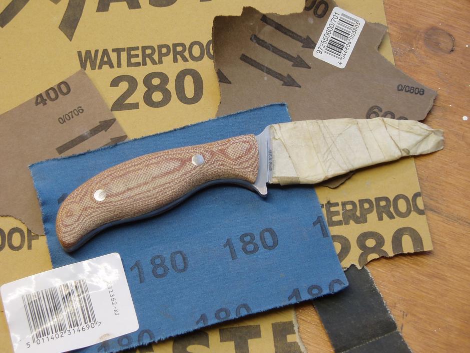

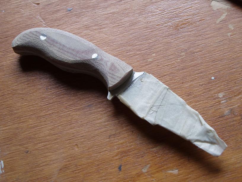

Next step is handwork. We sandpaper the micarta starting with 180 dry, followed by 280, 400 and 600 grit wet.
Check carefully at the start (using the 180) to remove all the marks and small dents made by the dremel-tool. Then works your way up with finer paper. You can make the handle as shiny as you want.
militaries 247.jpg (98.31 KiB) Viewed 3009 times
Tom

Wetsanding the micarta. When changing sandpaper make sure you remove all the debris and grit of the paper used before. This step also smoothens the exposed tangsides

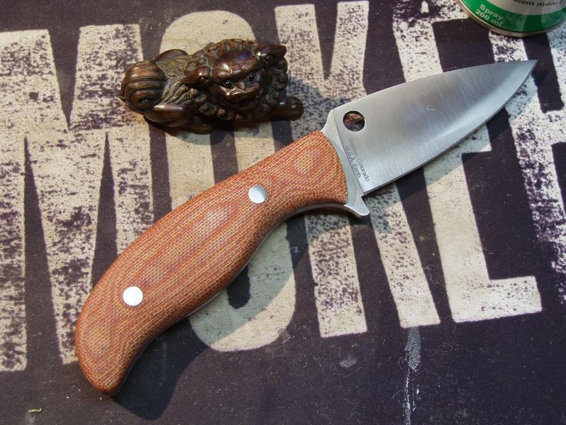

Post by toomzz »
Almost there. Now I let the mule rest for a day or so before I will finish. The final result will be judged first by the customer before publishing. I am becoming a slight feeling of a very familiar Spyderco FB.... :p
Cheers, feel free to jump in....
Tomas
militaries 253.jpg (100.83 KiB) Viewed 3001 times
