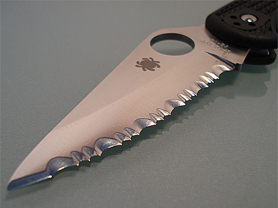

Why is it so special?
Usually, FRN folders feel extremely lightweight and have a neutral and almost non-existent balance. The thicker blade and steel liners in the handles of the Delica 4 fixed that. It feels much more substantial, but it’s still a lightweight in overall ‘feel’. It’s equal in this respect to most of my G10 Spydies.
Grip
The grip is immensely improved. The jimping on the thumbramp, the more aggressively textured handle surface and overall thicker and longer handle, make the Delica 4 every bit as nice and secure to handle as my Paramilitary for example.
Clip
Then there are the clip options. I always liked the D3 for its lefty-friendliness, but now I can carry it tip-down as well. Not that I would want to, ‘cause tip-up is best (!), but I like options. The D4 also comes in a SS version that’s (finally) lefty-friendly. I will check one out for sure. The hourglass clip is the best clip to date, next to the wire clip which is probably my favorite. The hourglass clip bridges the gap between traditional and wire clips. It looks and grips like a traditional clip but offers most of the comfort and low profile of the wire clip design.
Platform
The Delica 4 is not just a knife, it’s a platform. Already can you get about 12 variations of Delica 4 (including edge options). You have the regular FRN version, an all-steel D4, a blue FRN version with ZDP steel, a waved version and a foliage green FRN Delica 4 is in the works. And the knife has only been out for less than a year! Who knows how many interesting variations we can expect in 5 years?
Construction
The last major feature that should be addressed is the all-screw construction. Just like a Sebenza, you can take the Delica 4 apart without much trouble. There are many similar screw sizes, so you can’t mess up by putting the wrong screw in. Not only is this nice for us obsessive knifeknuts who want to clean and polish the innards of our folders. It also allows for easy modding. Since there is now a wide choice of D4 variations, mixing a waved blade with a foliage green handle should not be that hard to do. Of course you’d have to pay for two knives, but in the end you’ll still have two knives or one knife and a lot of spare parts. When taking apart and re-assembling the knife, please be careful with the FRN spacer unit. Both pegs need to be in the liners before you put tension on the lock spring.

The D3 was already a nice folder for this knifeknut, but it lacked a 100% secure grip so I used a pair of Natives as spare or back-up folders in my carry rotation. However, for me the Native has become a little too grippy. Those deep choils are excellent for hard work and MBC, but became a nuisance for me in fine utility work. They’re good knives, but my preferences have changed. For instance, I’m no longer interested in collecting pure MBC designs (except the Chinook II!). I like my ‘tacticals’ to be good utility designs as well. The Delica 4 handle design does just this. It’s grippy enough to keep a positive grip and smooth enough to transfer to finer cutting or scraping chores.
Blade
The blade has become thicker and stronger. I wasn’t too keen at first on hearing about the transfer to a saber flat grind and a more rounded tip. The D3 has always been such a wonderfully sharp knife with a needle tip. I admit I broke the tip of one of my D3’s when digging out large pebbles in a campsite to pitch a tent. And I have chipped the edge on a PE D3 when cutting computer cables. These were my own fault, I insisted on using a folder when I should have used a different tool. Mind you, on both counts the job got done and I was able to restore tip and edge. They just don’t look as pristine as when they got out of the box.
The D4’s tip is thicker but certainly not as dulled as I expected. It certainly won’t pierce a falling silk cloth by gravity alone, but it’s not prybar either. The tip is still sharp enough (even after resharpening) to pierce free hanging newspaper print. And the usual chores for a tip, like cutting out articles or opening bags, are still as easy as with my other Spydies. And let me reiterate; the tip maintains this performance after sharpening it on a Sharpmaker. Just remember to not slip the tip off the flats (the same holds true for all other blades BTW).
On the plus side the blade withstands a little more punishment. I didn’t pry rocks from the earth with my D4, but there was some garden work that put some pressure on the blade and tip. I moved a couple of large vines my parent’s garden. It involved digging up the main roots and cutting through some of them. I also had to cut out the branches from a wire mesh that was used to guide the growing vines. I got to work hard with a SE D4 for a full day. I pried, I sawed, I dug and I generally pushed the knife. Much more so than with my regular knives. Again, an affordable knife has its uses for knifeknuts. The Delica 4 held up amazingly well. After all my work on the plant, I had to cut some tarp to size and the SE blade still sailed through neatly. The blade was dulled, but not to the extent that it left a ragged cut on the tarp. The action got gritty since a lot of dirt got into the mechanism, but the lock-up was still solid.
