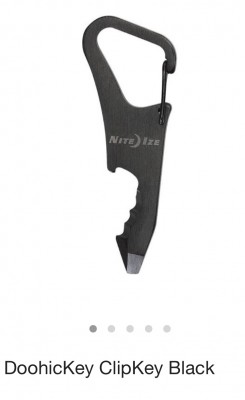

I think I found where to buy this...
It’s what I will use to make the prototype.
