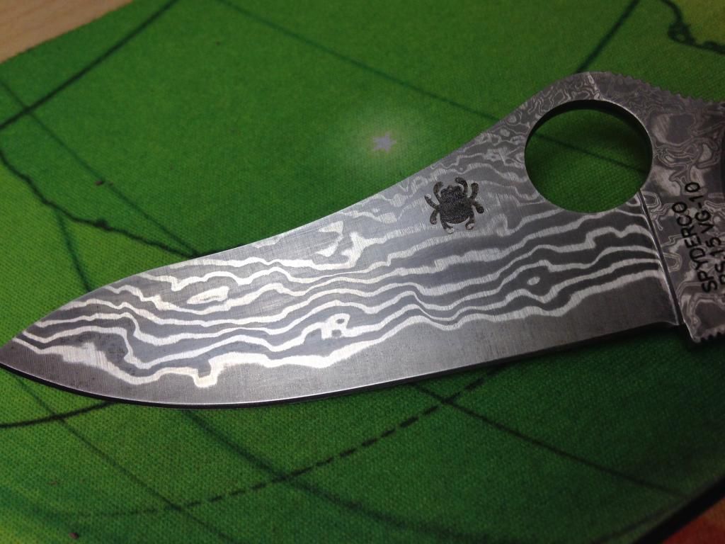

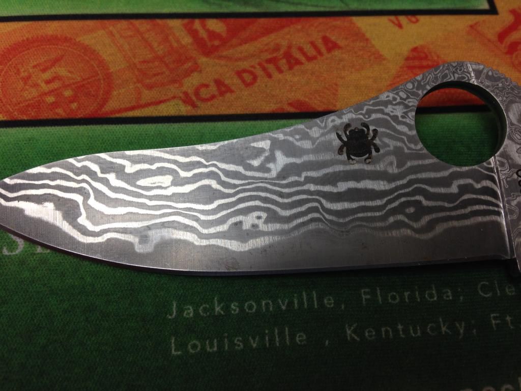

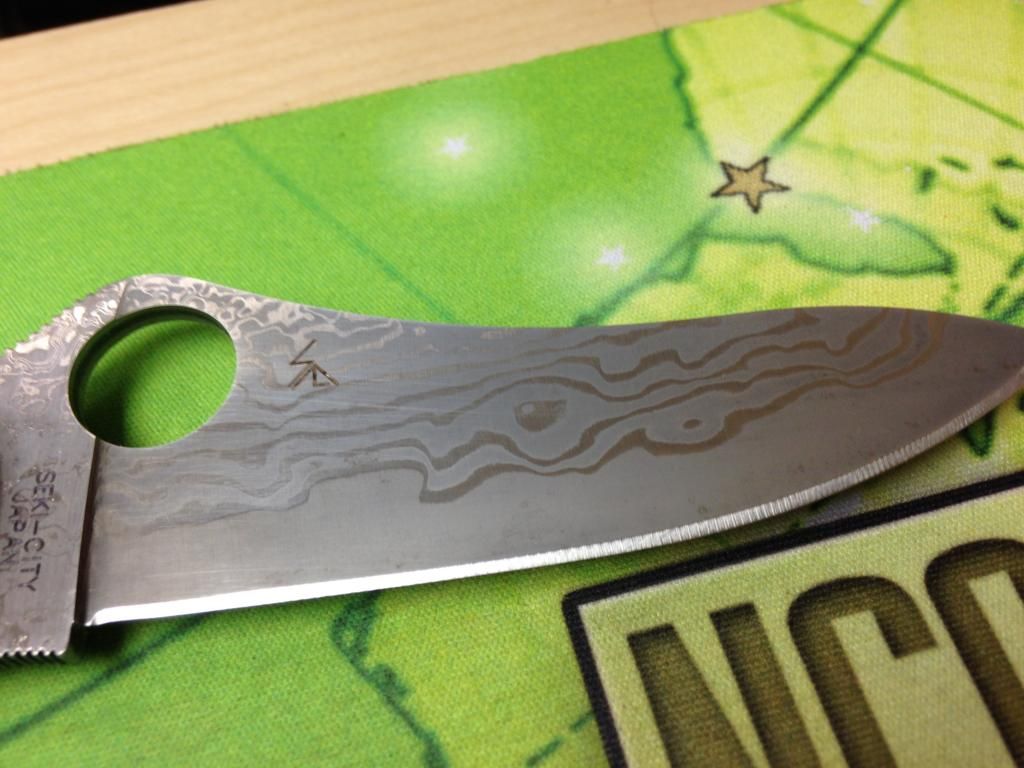

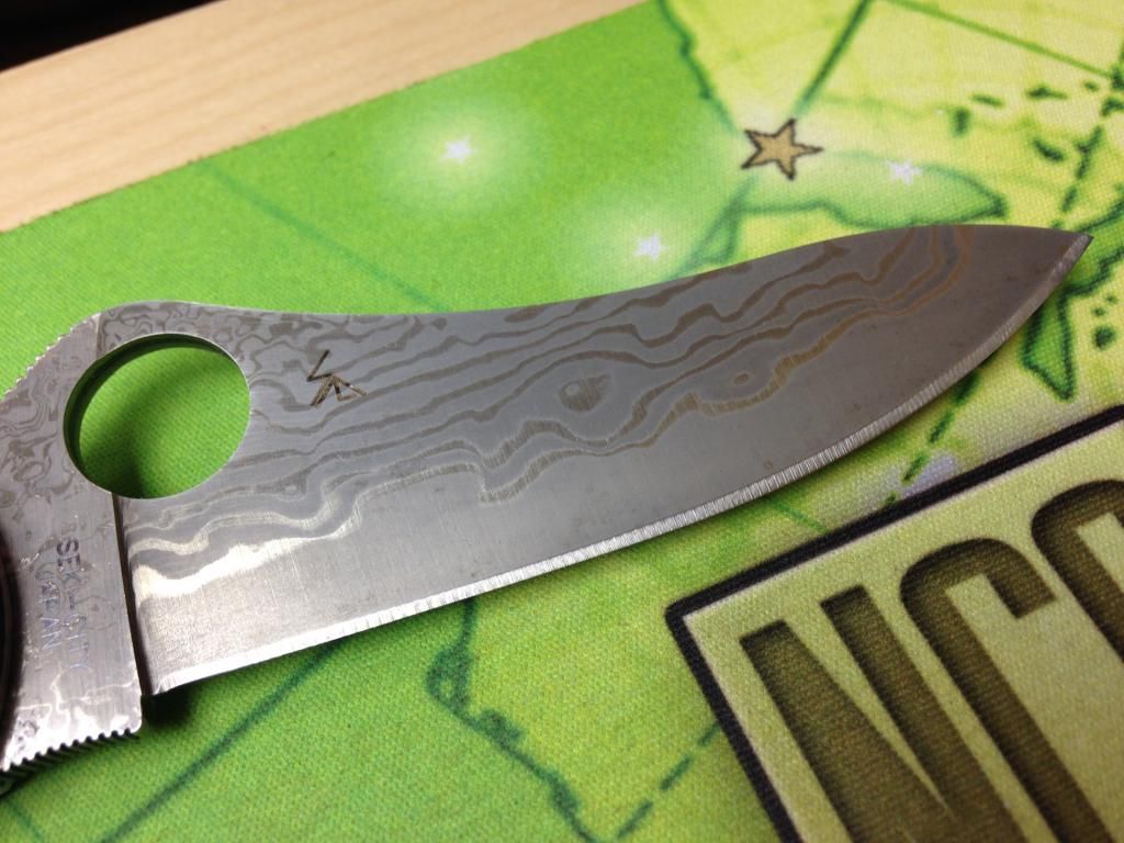

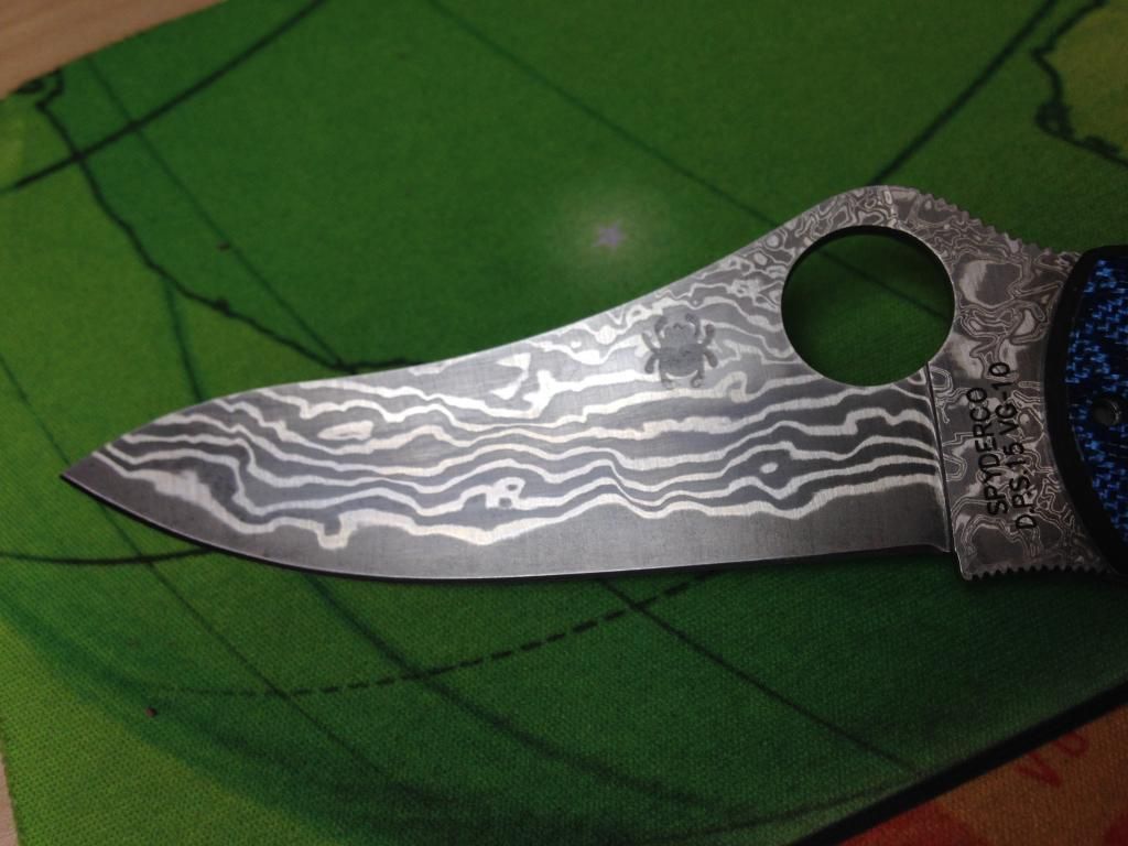

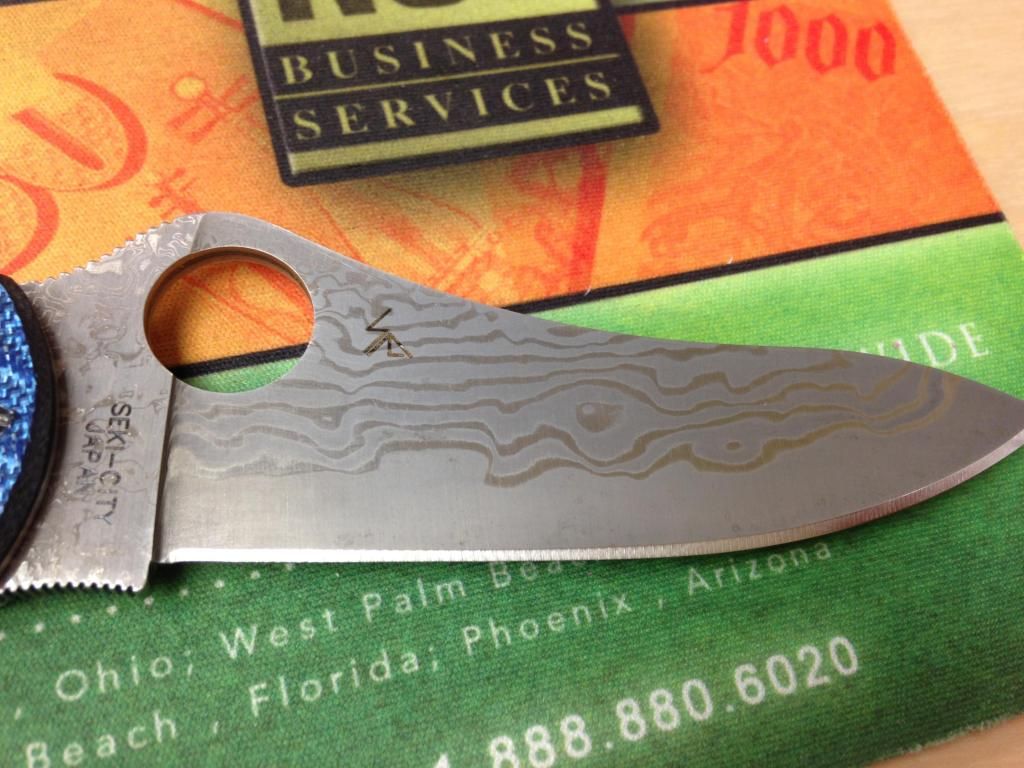

Hey Guys,
I am sorry for the time it has taken for an update.
I appreciate all of the advice you have given me.

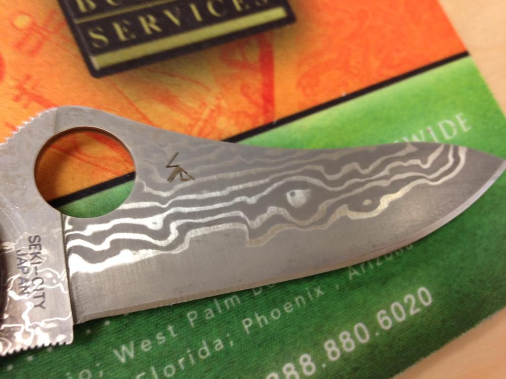

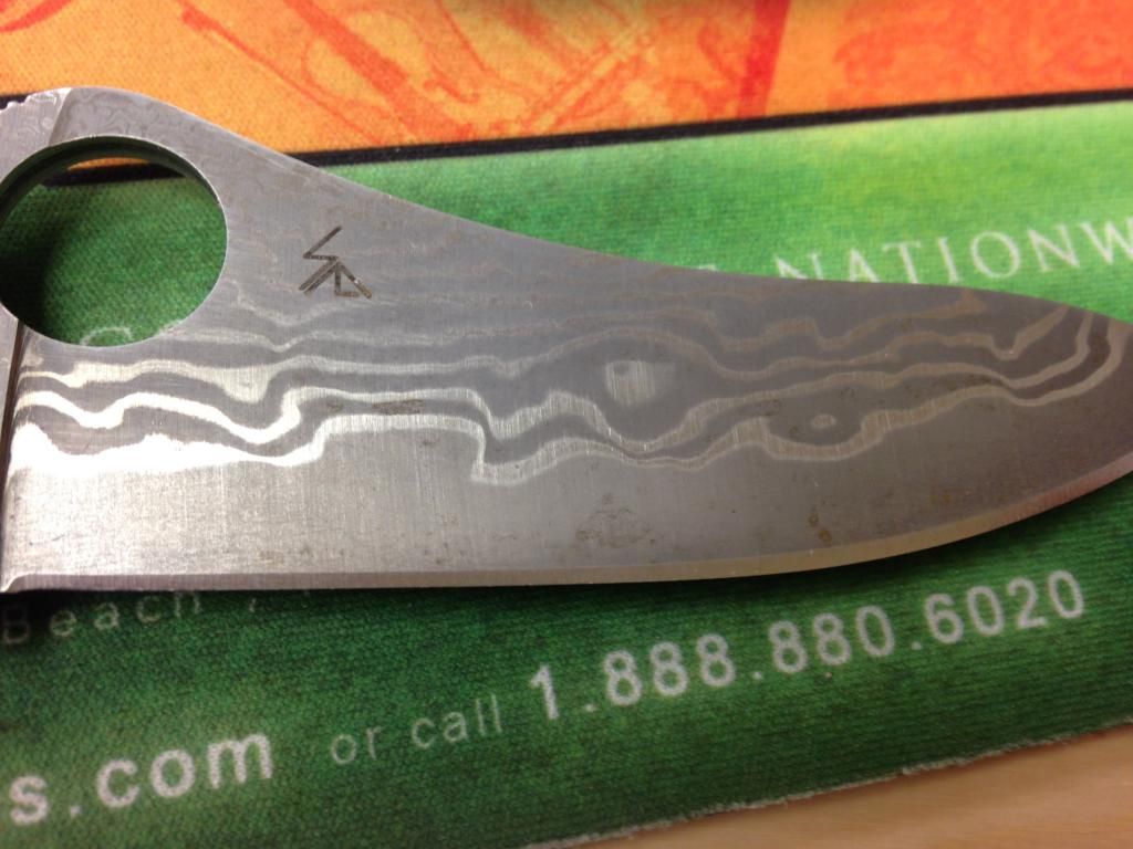

(At the suggestion of personal friend of mine) I ended up using a pencil eraser to start. I rubbed it pretty well and here was the initial reaction:
When i got a moment, I went to visit a freiend at my local shooting range, he put some FITZ knife + rifle wax on it.
Then when i got home i wiped it down with a silicon gun cloth and left it unfolded on to of my safe until this morning.
Before work, I took some CLP (G96), sprayed the blade, let sit for 60 seconds, and then wiped it. And throughout the day i have rubbed
on and off with the pencil eraser.

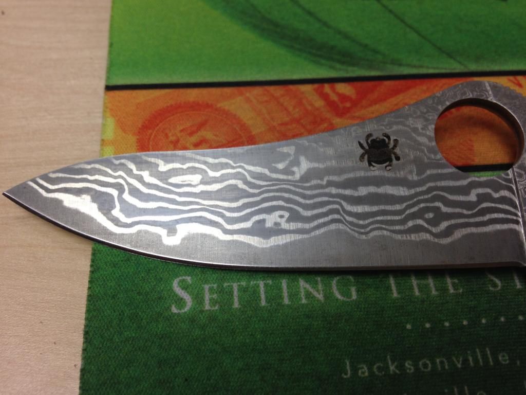

Here is how it currently looks:
I am pressed for time. I will be back on soon. Agian thank you all for your help.

I think that looks like some dang nice handy-work. :D Kudos on the success!

^ What he said. It's iron oxide; rather than going at it physically, go at it chemically.

Later Edit": :o Oooops, I didn't see your post before posting myself. I was looking at on older unrefreshed web page - but it looks like you got most of it off. Great work......perhaps not as pristine as a safe queen .....but a used knife also has a certain character too. I think sending it in would be redundant at this point myself since you pretty well cleaned almost all of it off. It was probably just a little damp and you just didn't notice before putting it away. When you do something habitually (wipe it down) and then forget to do it properly just that one time.....you will likely remember doing it properly because the memory of doing it over and over is likely going to stick in your mind rather than the reality of what happened.

Yes she is not as pristine, but i like her for her character and not her looks ;)
So far, 7 days later, no real perceptible change other than some corrosion like marks on the
black decals (spider, etch) on both sides. I'll try to post a pic later, I couldn't get a good one
here for some reason.

I would echo the caution in using anything abrasive like the rust eraser or scotchbrite pads. You can polish out the contrast between the different layers of the steel. This is purely cosmetic and can be fixed with a little bath in some etching solution... but that entails more steps...
I would just use a little silver polish and a soft cloth or toothbrush.

Hi J.Tank.
Actually it looks really good in the photos. Good job. We couldn't tell anything from the knife now that it's clean. Keep up posted if there is any re-occurance.
