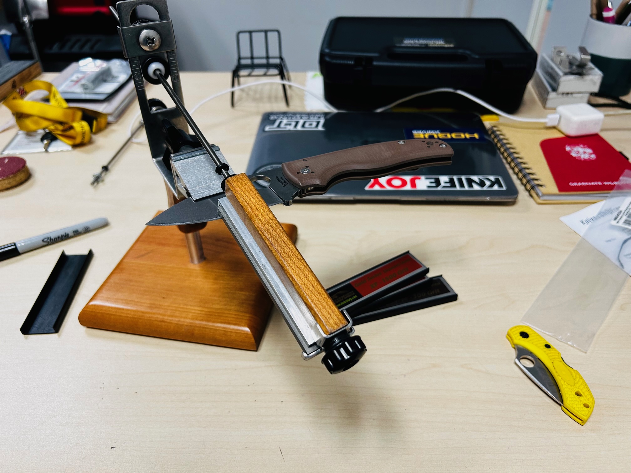

Post by JoviAl »
The tedium is real.

After a couple of days use of the 15V convex edge Shaman I have found it harder to keep it hair popping sharp, but it does seem more robust when working with local hard woods (unsurprisingly as the edge is at a slightly higher angle). It spools out wood beautifully when making feather sticks, but so does a HHG which is easy to keep scalpel sharp 🤷🏼‍♂️
As a control I’ve also convex edged my Magnacut mule which is thinner behind the edge and that performs very similarly. I’m not underwhelmed per se, but I think I’ll be switching back to a 15 degree per side fixed angle edge just because it floats my boat a bit more to have an extremely sharp edge that is long lasting.
If anyone else has any contrasting experience I’m all ears.
