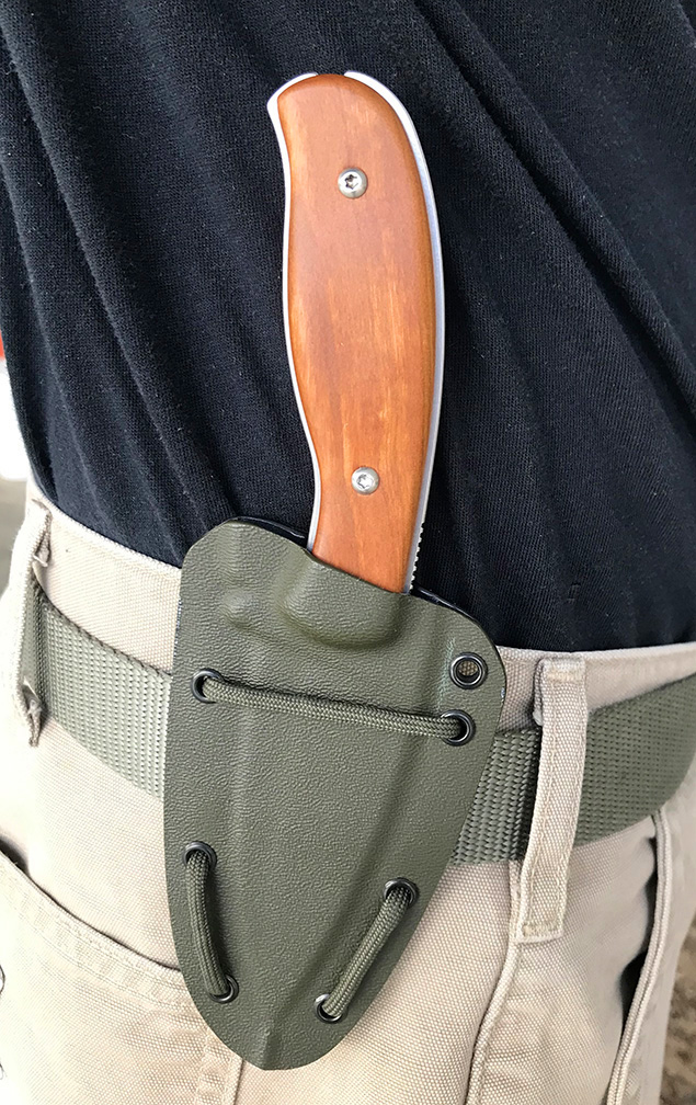

Now, I need to address a mistake I made...
:mad: :o :rolleyes: Oops! I "trimmed" too much! By trying to take the "thumb" ramp a little further forward I went too far and exposed the thumb ramp on the knife. Now I won't be able to push this part of the sheath to help the knife out.
Frankly, it's just as well.. ;) ...I wasn't loving this color or this shape anyway. I think I'll go with the blue instead :D .
Just imagine all the same steps..but in blue :D ;) .
When I considered eyelets I was intended to go with brass again. I usually choose to match the eyelets to the corbys in the handle. I almost never mix metal accent colors :confused: , that's just nuts :p . In this case the yellow of the brass against the blue sheath was just too "loud" for me. I don't prefer sheaths to be all that noticeable, so I went with black chrome even though it's a little out of place within the whole color theme I had going. :o
As I mentioned earlier, the eyelets are spaced to fit a G-Clip.
Last thing to do is clean up the handle "damage" from the heat earlier, restore the finish, and then polish the edges of the sheath.
Kydex polishes nicely by rubbing it fast on the leg of your jeans. Instead of wearing out my pants, I just attached pieces of canvas cloth to a board and called it a "sheath polisher". Great free tool! :)
OK..sheath is ready to go! My Mule is now ready for adventure :D .
