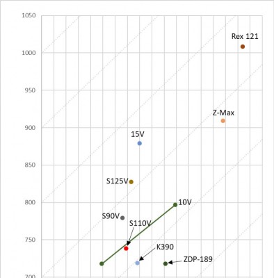

kennbr34 wrote:
Mon Mar 20, 2023 5:42 am
It's interesting to me that given how similar T15 and Z-Max are, that Z-Max is so much higher on Larrin's edge retention chart. Given their composition and micrographs, it seems like their carbide content is pretty similar...
Z-max is probably closer to Maxamet than T15. The carbon content effects how much carbide forms.
Maxamet 22% carbide 2.15% carbon
Z-max. 20% carbide 2.0% carbon
T-15. 17% carbide 1.6% carbon
Z-max also has a large moly addition that would contribute to a higher carbide %.
Last edited by Josh Crutchley on Tue Mar 21, 2023 11:02 pm, edited 1 time in total.

Josh Crutchley wrote:
Tue Mar 21, 2023 10:44 pm
Maxamet 2.15
Z-max. 2.0
T-15. 1.5-1.6
That would make sense, but just going by the appearance of the micrographs since there's no figured available, it seems like they have the same amount of carbide. If anything T15 appears to have a little more. Yet Z-Max is wayyy higher in the CATRA test.

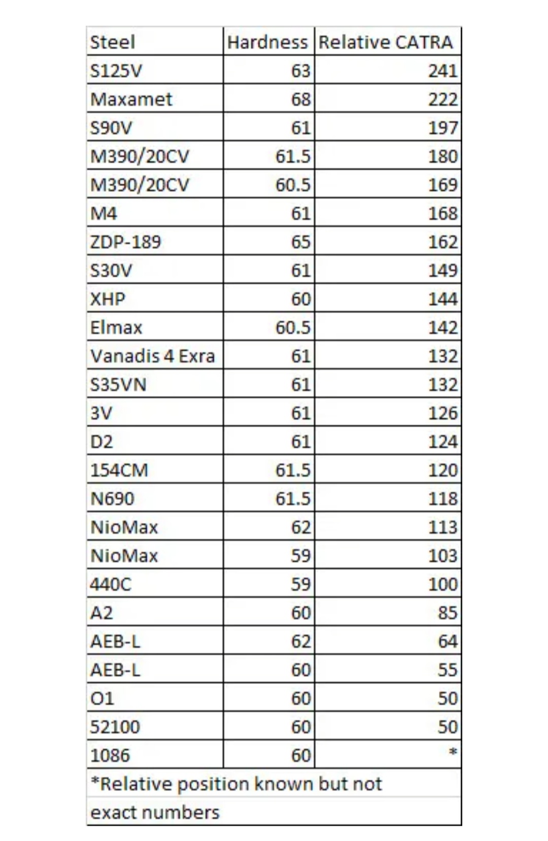

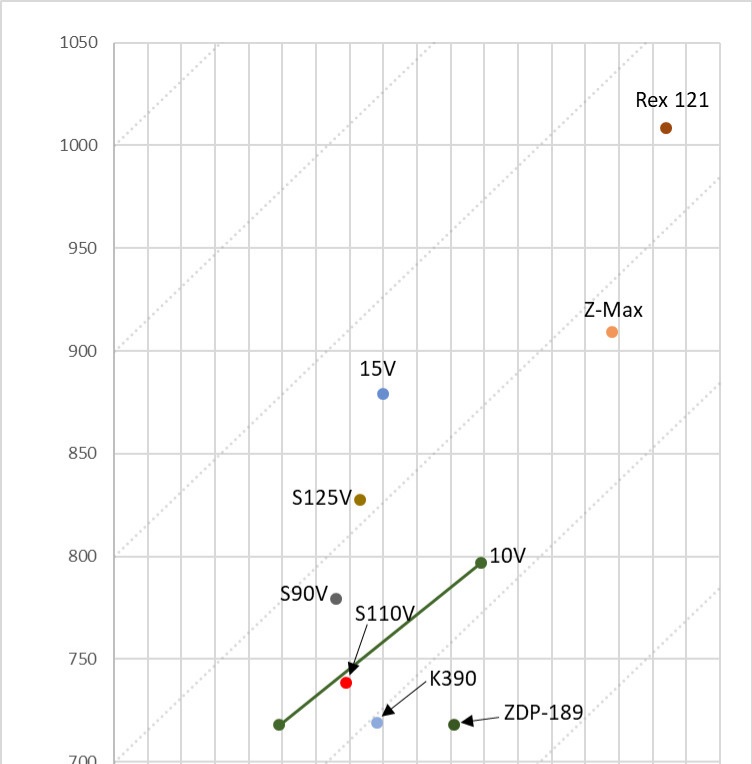

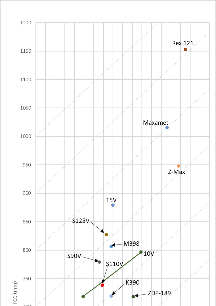

kennbr34 wrote:
Tue Mar 21, 2023 11:01 pm
Yeah I think Z-max and Maxamet score higher than predicted by the formula. The numbers for carbide volume on Knife Steel Nerds are all over the place. That makes it hard to use the formula when you're not sure what numbers to use.
It's also possible T15 could score higher with an optimized HT. Rex-121 jumped up the Catra chart when it was retested with a more blade friendly HT. Z-max also jumped up some when comparing the newer charts to the old ones.
Something else I just noticed, Maxamet was predicted to come in below S125V in the last chart.
Wed Mar 22, 2023 12:20 am
Hmm never noticed that with S125V being predicted over Maxamet before.
After reading around Larrin's blog more, it seems his data set is pretty limited when it comes to molybdenum/tungsten carbide based alloys, so it seems like the equation might not very accurately predict the performance of Mo/W carbide alloys vs Vanadium carbide alloys ad well as it predicts Vanadium carbides vs Vanadium carbides.
I wonder if there's a way to ping him to weigh in with an opinion? It would be cool if he could tell us specifically what the carbide percentages are too.
In any case... Darn. I was really hoping based on the compositional similarities that T15 would hang around up there with Z-Max for a second. My excitement kinda fell off when I saw Larrin's numbers.
It seems like it could make decent competition for 10V if it has better corrosion resistance and grindability. I wonder if it could be a little cheaper to produce but offer similar performance if it was easier on the grinders.
I guess I am just struggling to see what the advantage to this steel would be or if it's just an opportunity to try a different flavor
