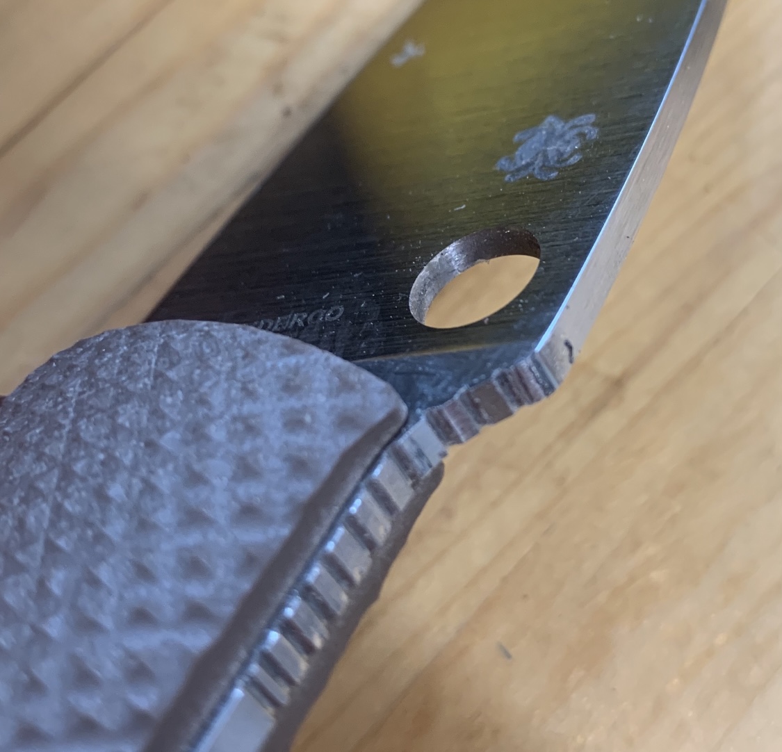

I felt the need the moment I picked one up. I searched the forum and read your backpacking mod thread. Thanks much for the inspiration.
I had mixed results in my journey. I wanted to try it on my PD1 mule. Picked up a checkering file and tested on aluminum stock. Looked perfect. Then tested on mora garberg 14c28n. Took effort and 15min but came out great.
Filled with confidence, I went to work on the mule. After about 45min I barely had scratches.
After more research, it seemed I needed a diamond file. I picked up a straight triangle coarse diamond file from McMaster. I ended up with functional but not so pretty jimping. I’m thrilled with how it feels.
Now I’m thinking of how I can improve my efforts and do it to the Magnacut mule. I’m open to suggestions. I’m also really interested in the reduction of the ramp. I’ll be watching for that. Thanks to all for sharing.
I've not seen diamond file jimping before, thanks for being the point of the spear on that. I think it looks good and is obviously functional. I do my jimping with a 60 degree carbide engraving bit on a hobby mill. I take passes of, ooohhh, maybe .005 at a time?

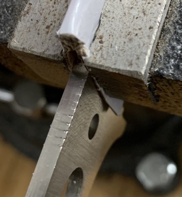

I had another thought (sorry, I'm old enough that all my thoughts don't occur simultaneously). Depending on what kind of drill press you have, if the quill is precisely adjustable for Z axis, you wouldn't have to turn your vise on edge (and possibly, although doubtful, not even use an X-Y vise).
My dad has an old style drill press where two large nuts jam up against each other to set how far the quill lowers. On a drill press like that, you could precisely lower the jam nuts a certain number of turns and make your next cut. It would still be handy to have an X-Y vise though, since you probably don't want to make your total depth of cut in one go. I tend to move the work past the cutoff wheel in the Y axis, then give a little more X axis for depth, and do the Y axis again, repeat. Honestly it doesn't take much depth; don't go too deep. I find that .020 to .030 depth of cut is plenty for me. Whatever makes your thumb happy.
Also, remember that your thin cutoff wheel will be losing diameter as you go, so when nearly finished, I go back and do a final light cut in all my jimps to final depth.

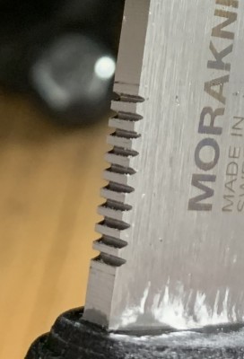

Here's a photo of a ute knife jimped with a Dremel-style cut-off wheel...you can see that the jimping is not as precise, due to some inevitable wheel flex, but it's "thumb acceptable" and feels great.
Alternately, you could do 80% of your cut with the Dremel wheel, and then finish up with your triangle diamond file. That might give you the best finish, but I haven't tried it myself.

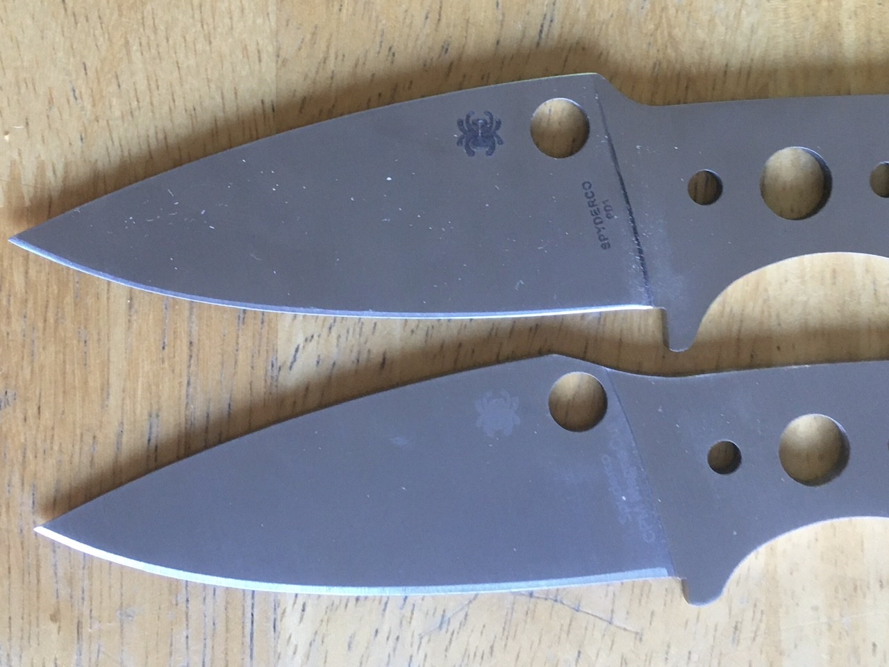

I ground down the abrupt thumb ramp to a more gradual one.
Also, to allow the leather mule team sheath to actually work with my mules, I also ground about 1/3 of the kick off.
Here’s the PD1 as far in the sheath as it’ll go:
Here’s the modified Magnacut as far in as it’ll go:
Overall, I’m pleased with the result. The thumb ramp started out looking a little odd and still does, just differently, but at least now it’s comfortable.

Strong work, Attila. I can imagine the more gradual thumb ramp makes a big difference in comfort...I think I'll start doing likewise to my mule mods. Looks a lot more like a Manix with the gradual ramp, doesn't it?

Yes, the gradual thumb ramp is like an unjimped Manix’s.
Also, I made sure to try this mod only after I owned multiple copies of the same mule. My other Magnacut mule is NIB (and much thinner BTE), so I didn’t want to risk ruining that one.
I’m going to ponder how to improve upon the idea before grinding any more of my mules.
