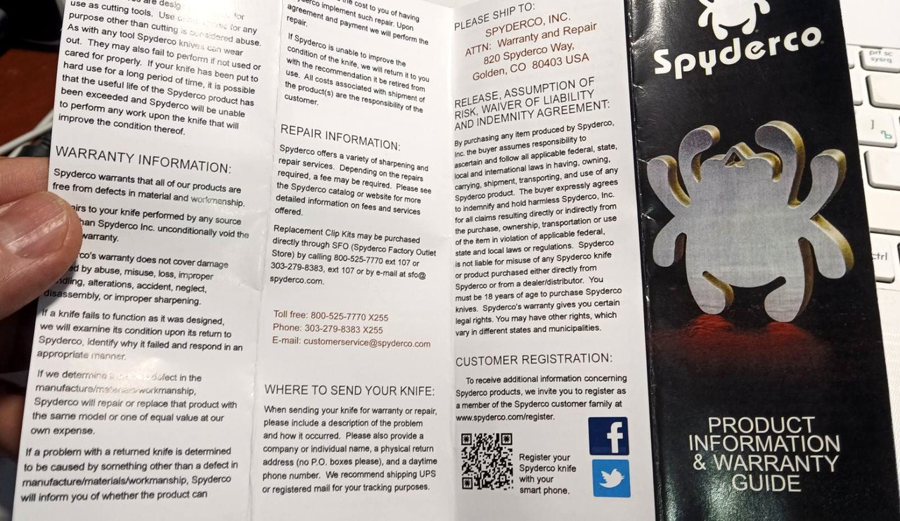

Re: Spyderco Knock-offs, "Replicas"and Fakes
try to refute;
can do the same with endura 2014
fake, dull notch
original, sharp notch
P.S. Even if this delica really was from the old ones, then even though the pivot screw is a little similar, it’s still different, besides, the gaps between the groove of the axial one and under the clip weren’t back to back then, and most importantly, the inscription Seki and Japan were not made by laser then , and stamping
the clip is short and the spider close to the edge
fake, red font of adress and phones
original
Fake: "ТМ" vs ® after "Delica", captions under images
Original
fake, dull notch
original
Original

I will personally explain this point to you, as a specialist in the field of registration and protection of intellectual property objects, - the TM designation is added to the image or text of trademarks during the process of their registration. And after the trademark has been officially registered and the Certificate of its registration has been issued, a publication has been made in the official bulletins about the registration of such a trademark, then the TM designation is replaced by ®.Makunochimaster wrote: ↑Sat Nov 26, 2022 2:32 pmfake, red font of adress and phones
This indicates that this knife is from the first releases when the DELICA trademark was in the process of state registration. And the booklet shown by you is from a later version, when TM DELICA was already registered.
With all respect - the fact that you are not aware of such nuances, and a priori consider knives with booklets with the TM mark instead of ® (or determine the originality of the knife based on the analysis of the box or booklet), in my personal opinion, does not at all indicate your expertise in this matter...
- Makunochimaster
- Posts: 1914
- Joined: Wed Dec 25, 2019 5:40 am
- Location: Ukraine
Also, there is no barcode sticker. it's fake 120%.
In addition to the sticker, there were other questions:
-short clip, larger than the original;
- the pivot screw is not the original shape;
-reduced gap between the axial groove and the holes for the clip;
- the inscriptions are not stamped but applied with a laser, if it's old knife;
-general crooked casting texture FRN;
-descents start too close to the spider-hole
