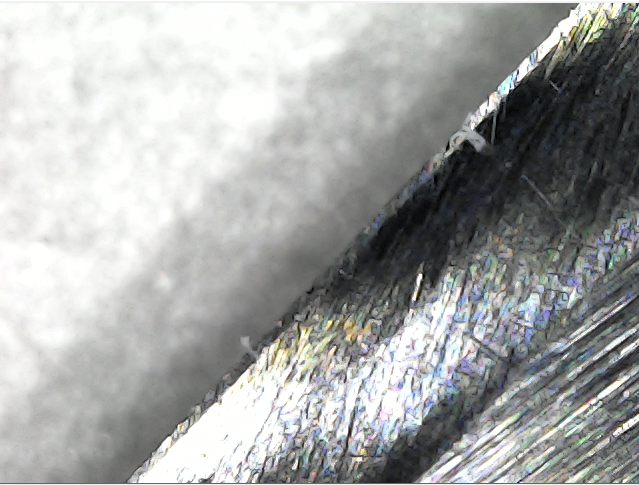

Success!
Below are my limited observations and experience taking a first stab at sharpening this HIC Mule...
1st: Don't try to sharpen by hand
2nd: Use a belt sander with a very fine grit and hard carbides and/or diamond stropping paste
3rd: Go slow and have patience
I started by using my 1x30 mini bench top belt sander with a 800 grit aluminum oxide sanding belt. I didn't see much effect with using the sanding belt alone, so then I applied some yellow DMT diamond stropping paste to the belt and periodically re-applied to uncovered areas as I progressed (note: make sure you get paste all the way to the edges of the belt). Using the flat steel back-plate on the sander, I alternated taking slow passes (couple times per side) using very light pressure and my thumb to stabilize the blade to prevent chattering. I found this to be very effective to even and smooth out the factory grind lines (which came irregular and a bit wavy). Full disclosure... I hand sharpen ALL my blades on bench stones, so using an electric belt sander was a bit of a new experience for me, so it took me 5-10 minutes to get my technique consistent and find the right bevel angle. I also found that moving the blade ABOVE the flat back-plate, decreasing the angle of the blade, and allowing the sanding belt to slightly curve around the bevel as I made passes (much like a strop), really helped to refine the edge.
I spent about 30-40 minutes take slow, light passes (not much pressure, and not much heat build-up), and I have a pretty good working edge that I'm pleased with... but it's still not hair shaving sharp so I plan on spending another 20-30 minutes tomorrow with some more diamond stropping paste to see if I can get it hair shaving sharp. Given how long this takes with a belt sander, I wouldn't recommend anybody try and sharpen this mule by hand... you could spend all day.

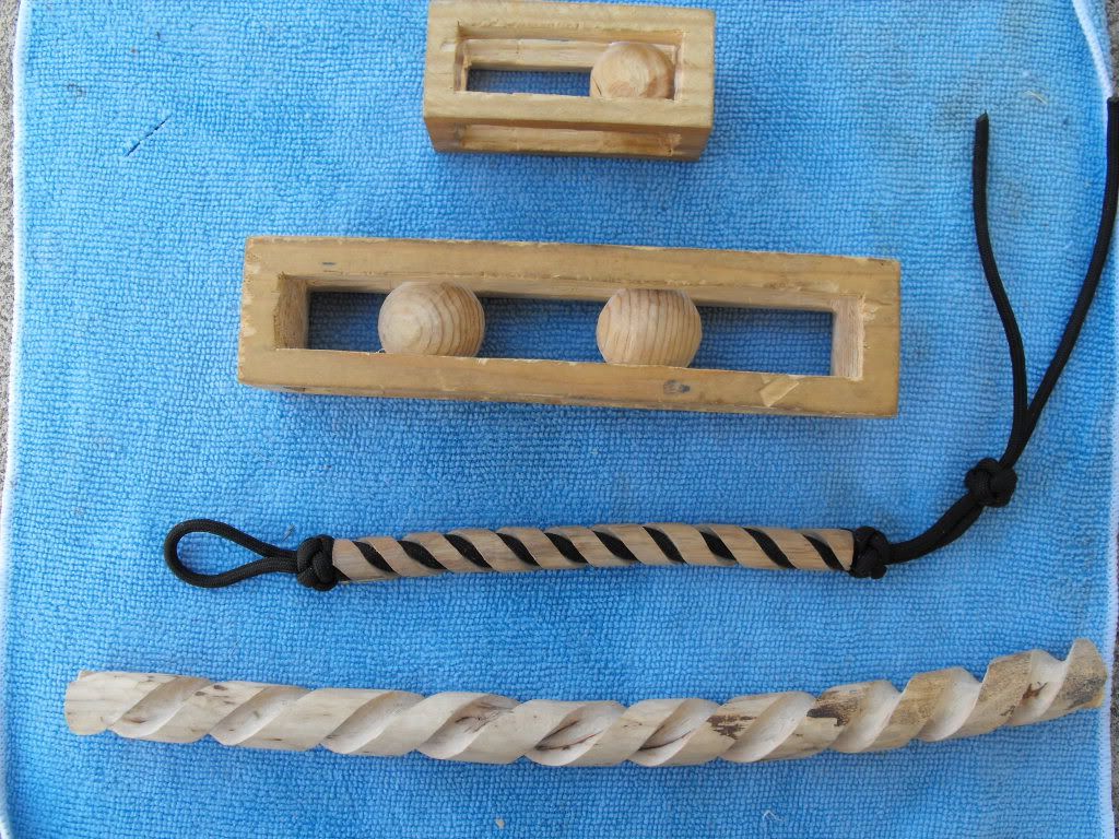

I am new to ceramics, so I don't know how it will hold up if I do manage to get it shaving sharp. My goal is to find out.Bolster wrote: ↑Thu Feb 15, 2024 10:06 pmAnd while I've got the microphone, another question: Let's say you do manage to get the ceramic hair-shaving sharp. Does it hold that edge well (ie, at least as good as a quality steel), or does it quickly fracture back down to a long-lasting (but duller) edge that it can actually hold? I guess what I'm asking is whether pursuing a fine edge on ceramic is worth the trouble, or does it quickly revert to a working edge?
And for Yab: Any twisting cuts in hardwood?
As for twisting cuts, if you mean digging the edge in deep then twisting the blade to break out a piece of wood, no. I personally think that is stupid, proof positive that the person doesn't know how to use a knife and shouldn't be allowed to handle sharp objects without supervision. Just my opinion.
That said, what I have been doing is carving flutes - rounded spiral patterns like the bottom piece in this old picture.
That is done with a scooping motion that does put a little lateral stress on the edge, but not much.
Edit to add: I have a hunch that the "30° per side microbevel" that people have been observing is what remains of the manufacturer's edge after Spyderco has worked on it. For those who have spent the time and put an acceptable edge on, try to picture doing that 2000 times. If Spyderco had waited until they had achieved the level of sharpness people seemed to be expecting, this Mule would have dropped in 2040. Food for thought.

I used DMT diamond blocks. I first tried the 1200, but felt I was basically not doing anything. I backed off to 600, and it was still slow going, but I could at least feel it cutting. I stayed there for a while, trying to re-establish a new edge, then back up to the 1200. I probably spent 10 sharpening minutes on the 600, checking edge and bevel often, then took a pic. I then did the same on the 1200, for maybe 20 minutes, checking push-cut on printer paper fairly often. Once I got it to a satisfactory paper cut test, I stopped and took some pics. Then I did a light couple strops on the 1200.
Here is the pic after 600: Here is the result after the 1200: Then here is after the stropping: None of these felt really sharp on a 3-finger test. I never felt or saw any burr form. Also, the 1200 diamond plate also feels WAY too smooth now. It's far smoother than the 8k diamond plate. I am not sure how much more cutting power it has left, so this could get expensive if you had to sharpen this material often, or need to work out chips (made a little one on the corner of the plate and and did get it out). I can't really quantify the plate effect, but it definitely looks a bit different. It may look like a focus issue, but it is different through the range of focus. The very corner of the plate still looks like the before, and everywhere in the middle looks like it has less "depth" in the media.
Before: After: Now, before I work on the mule, I took some pics:
Side1: Side2: It looks like one side is rolled over. I took a bunch of pics, in different places, and it definitely looks like a convex edge on one side moreso than the other.
More to come...

First, I have traditionally done all my sharpening by hand on waterstones. So take anything posted here with that in mind. Second, this material is stupid-level hard, and the entire "feel" is different than anything I have sharpened before, so definitely a bit of a learning process. In particular, my three-finger-testing felt useless - it almost never felt like it was "biting" - too smooth.
More to come...
-burly

I did not consider this with diamond, but my 1200 feels like a 12000 now, after re-profiling my factory-edged Rahven. Pretty sure I spent $47 in about 20 minutes getting a mediocre sharp edge.
