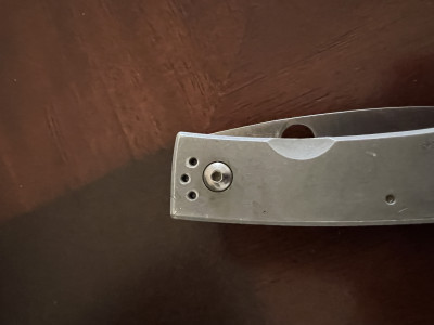

This beautiful knife was my introduction to the World of Spyderco. I purchased it new in the late 80’s from a Spyderco dealer in VA. I had no idea what it was, I just found it beautiful and unique. It was the first “expensive” knife I ever bought. Now, 40 years later and dozens of Spyderco knives, and many attempts later, I have found this forum, and I’d like to try to get some help. I am sure I’m not the first to ask, but I would give about anything to acquire a functional clip and screw set for mine.
We were all young and dumb once and whatever possessed my to turn this into a pocket knife and forego the clip is beyond me. Mine has aluminum scales and a black insert. Here is a picture of the scene of the crime…
Last edited by Webb Benninghoven on Wed Dec 24, 2025 8:22 am, edited 1 time in total.
Wow Sal, it’s an honor to hear from you! Yes I did. They said they didn’t believe they could help due to the age of the knife, as they didn’t have replacement parts, but asked me to send it into them to take a look at it. I was too reluctant to send it as I have had it for so long. All the knives I have are yours, including the kitchen knives, my wife uses. So even this one that’s not 100% was just impossible to part with. I just want to make it whole like the rest of my collection
